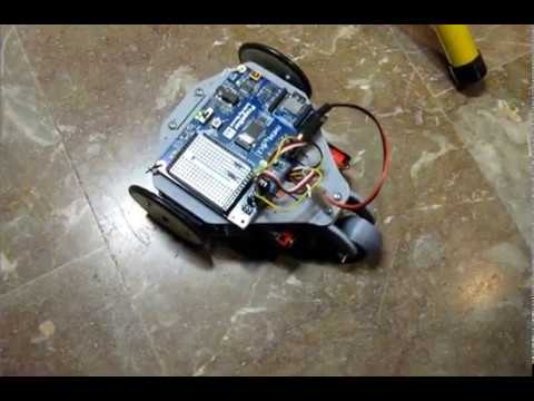

Hi,
I'm in the process of the design of an affordable mini robot for my students with super capabilities, using the Propeller FLiP microcontroller module
powered from the PowerPal Selectable Voltage 3-Amp Breadboard Power Supply
The chassis and the rest parts of the robot will be 3d Printed...
For the motors, I'm not sure yet (probably cheap geared steppers.....)
But the main part I'm looking for is a Shield in order to adapt the Flip and the PowerPal.
The simplest way is a mini breadboard like the NICERC DIY Breadboard Circuits Kit or the Circuit Overlay Board
Is there something else for that purpose??

    Here is the basic platform for my design:
    The shield will be very simple, will accommodate the FLiP and the PowerPal and some Schokets for servos. When the shield is ready will replace the breadboard. The dimensions will be 76mm x 40 mm approximately
    1824 x 1368 - 1M

    Roy's board has the ideal size and geometry for my robot...
    I think that it fits better in my chassis. I think that would be better to place the Power pal next to the long side of the Flip...
    Here is the robot till now...
    I've ordered some Parallax Feedback 360° High Speed Servos at Thanksgiving sale and I'm waiting to put them together

    I have not the final design because I'm trying to find the perfect tail wheel for that robot. So I'm going to "play" with dimensions a little bit in order to be ok with the tail wheel.
    For rough research, I found a 38mm diameter Omni wheel:
    Although the perfect size would be a little bit smaller I' think that this wheel is good enough
    However, if anyone has seen something smaller than this, or something similar, please let a comment.
    When the project is finished I'll post the G-code and STL files in this thread as well as
    all the list of materials
