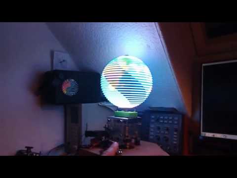

Hi,
i just want to show you my new propeller project, a POV globe with 64 RGB LEDs.
I use the APA102 that are cascaded and can be switched very fast via SPI.
The LEDs are firing by two cogs with clusos CpuBlade !!!
The 120x64 bitmap with 24bit color is load into the propeller via sd card.
Complete instructable
Regards
Christian

    But I have to ask, why was an Arduino necessary for "critical timing"? I would have thought that the Prop could have handled the whole lot standing on one of its eight heads.
  • TharkunTharkun Posts: 67
    edited 2017-01-11 16:24
    No, the arduino only generates the pwm for ESC/Motor
    Surely the Prop can do that PWM thing as well ?
  • Heater. wrote: »
    ÄÄhhhmmm. Yes of course. But the Prop rotates 40 times/second and i've enough problems to get power to the ring ;-)
  • SeairthSeairth Posts: 2,474
    edited 2017-01-11 16:53
    Beautifully done! As Peter suggests, you could certainly use the Propeller for your PWM output (and button input) as well. Add a hall-effect sensor on the shaft and you could have the Propeller automatically set the speed.
    Edit: Ahh! I see. The Prop is on the rotating part!
    Edit edit: well, there's a way around that! Put the motor and ESC in the rotating part too! ;)
    I see. Fair enough.
