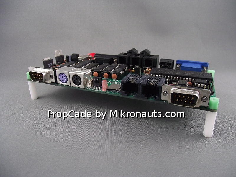

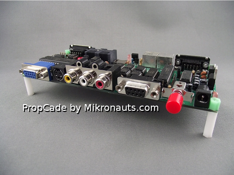

    Here are a couple of photo's of the new revision of PropCade - all features work :)
    I expect to have production boards by the end of the month!
    Now I just have to figure out the BOM and pricing...
