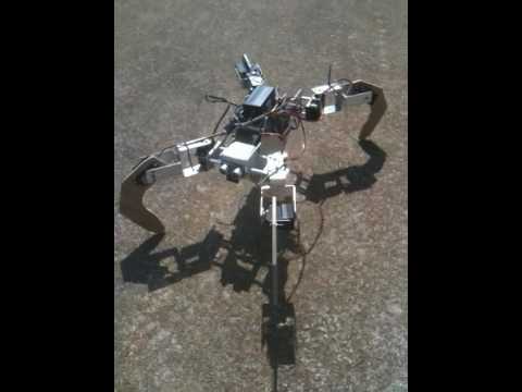

Hey guys, just putting an update on my Quadrapod. I have the power system working for now. i was being dumb and trying to run everything of of just 5 rechargeable AA's and it just wasn't working. So i put another pack for the BASIC board and put energizer rechargeable AA's in for the servos but will have a 3000mAh 6V battery pack in it soon.
I have it walking on its own its just programed with a simple forward gait for now. I am trying to figure out a fluid single leg gait but that is a little more complicated.
Any way here is my video of the progress....[noparse][[/noparse]url]

Otherwise you could use a couple of appropriately rated diodes in series with the 7.2v packs to drop the voltage by 1.4 volts.

Amazing effort. As you said, getting the right gait isn't easy, but please keep going and share your progress here. Looks like you did quite well on the mechanical construction, that's the hardest for most people. Now it's all in the software routines.
BTW, what controller are you using?
