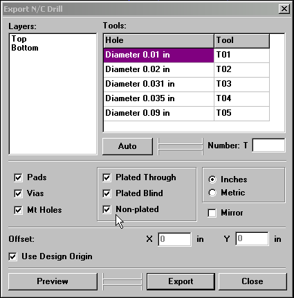

Which files contain data whether a through hole is plated or not, the NC drill or the Gerber?

    I am asking PCBCART to make some boards for me. The boards contain holds that are both plated (all vias and DIP ICs) and not plated (fastener holes). I am concerned that with the Gerber and drill files they ask for are not sufficient to denote the difference. I use Diptrace as a cad package. I have the board and all Gerber/drill files PCBCART wants for the fabrication job. What will happen with my board?

    I just loaded up your gerber and the DipTrace file (I also use DipTrace). The data is correct, but as Phil mentioned, it will depend on how the fab house interprets holes drilled on top of copper pads. The default I have seen is that the hole will be plated. I have a design being made right now that was done in DipTrace in the same manner as your file and the holes are plated where I expected. (on your board for example, I would expect the two AC and GND holes to be plated through). As a confirming effort, you could make a fab drawing to go along with the gerber package. Attached is a sample of what a drill chart would look like in a fab drawing. The chart defines drill diameter and whether or nto they are plated. Each one has a symbol (letter) that can be seen over the appropriate pads in the file.
    In DipTrace, you can also export separate drill files by checking/unchecking the "Plated Through" and/or "Non-plated" options in the Export N/C Drill dialog box.
