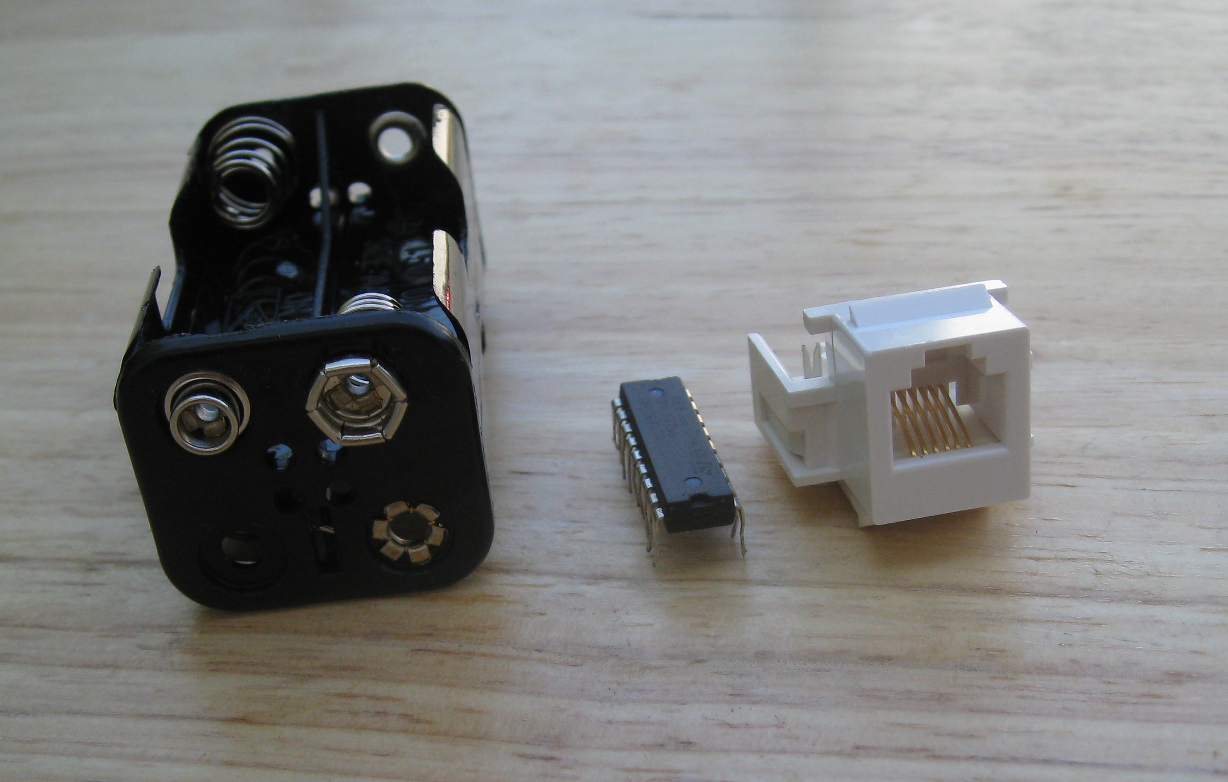

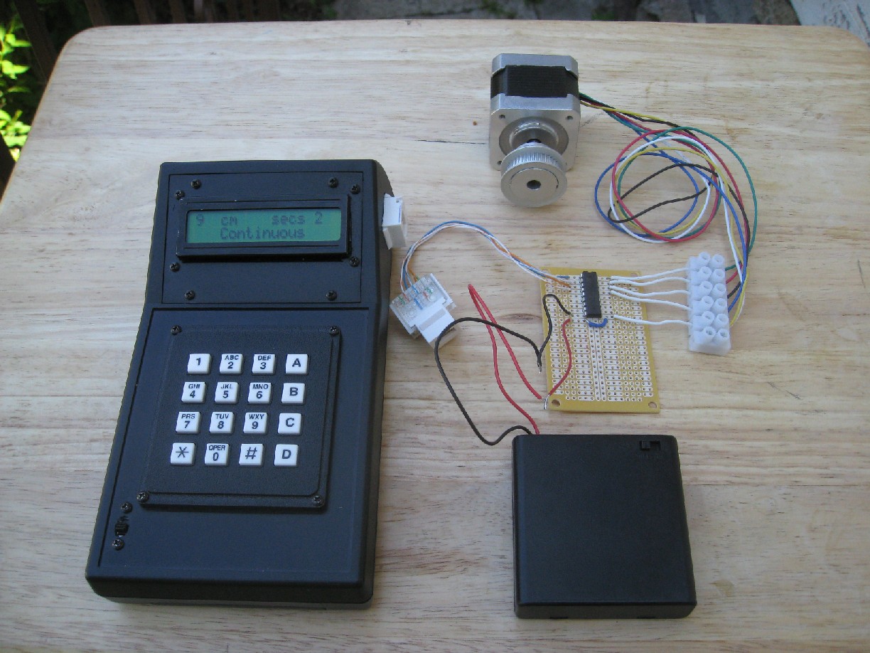

@Phil Pilgrim, as you can see I've got the black oxide machine screws. I had to order the terminal blocks from Gadget Gangster.

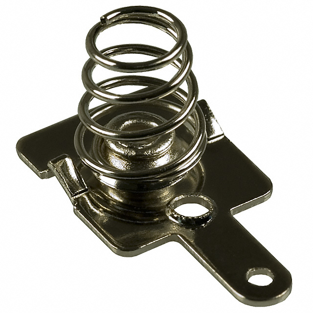

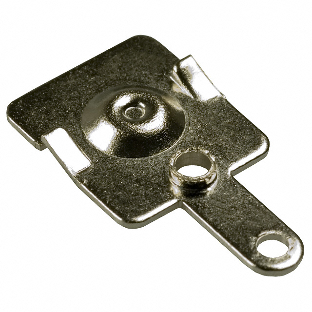

Positive Pole w/Tab Battery Contact
search.digikey.com/scripts/DkSearch/dksus.dll?Cat=393339&k=5226K-ND
Negative with Coil&Tab Battery Contact
search.digikey.com/scripts/DkSearch/dksus.dll?Cat=393339&k=5204K-ND

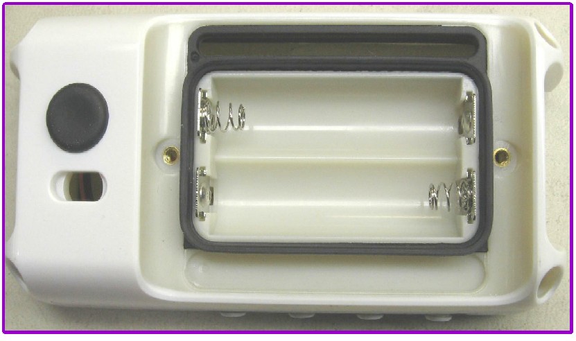

Third pic is of the case they were used in

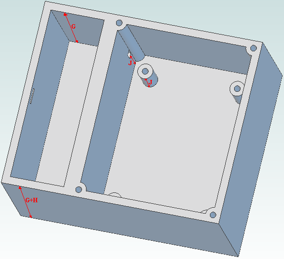

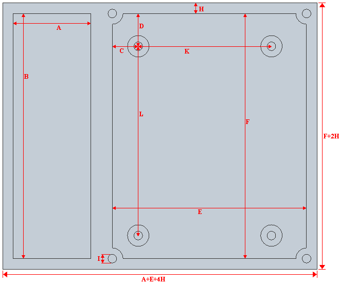

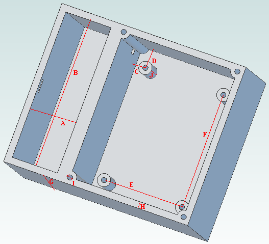

B=66mm
G=30mm
E=30mm
'A' looks like the battery compartment. The perf board and the RJ11 connector will fit easily inside "E". I don't even need the standoffs indicated @ "K" and "L".
· I would leave the configuration of the battery compartment up to you. Your expertise would be better than what I could come up with. I especially like the idea of a battery lid. I will order two if the set-up for the second box is easier. (One is fine) I can complete my prototype with what I've seen and I've started ordering supplies for two machines.
Lots of propeller based products in stock at affordable prices.
this box was designed with a 9v battery in mind where you have a connector on the end of a wire
search.digikey.com/scripts/DkSearch/dksus.dll?Detail&name=BS12I-HD-24AWG-ND
no special config needed. AA batteries require chambers for the individual batteries with connectors screwed to the walls.
