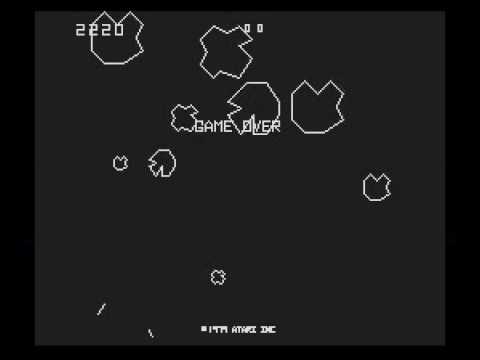

    Call me old but, where I come from "Vector Graphics" means exactly that.
    For example, if you want a 30" diameter radar display with maps and aircraft etc. possibly with some text annotations, possibly in colour, and if your processor only has maybe 64K RAM. What do you do?
    Forward in time and you are ATARI and you want to make the Asteroids game on an 8 bit micro with not much RAM, what do you do?
    Drive the x and y axis of your screen and draw vectors, that is what you do.
    Anything else is not vector graphics IMHO.

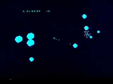

    BTW, that game has been ported to the Atari 8 bit computers. A vector to raster layer was implemented, allowing the original 6502 arcade code to run on the home computer, drawing to the raster layer, instead of the CRT.

    potatohead: Yep it was. With sad result of a chunky low res raster display instead of the high res vector original.

    @Heater, I'm not sure we are talking about the same port.
    That is the real arcade code, running what it thinks is a vector display, not the older chunk-o-roids one from long ago.
    Still, your point is valid. A real vector display actually draws vectors...
    I was impressed by the quality of the port, and that the vector to raster conversion could be done on a 1.7Mhz machine at playable speed.

    @potatohead: "I'm not sure we are talking about the same port." I'm not sure we are talking about the same port[noparse]:)[/noparse]
    That may well be the original code driving what it thinks is a vector display which ends up being a raster display. And as I said it ends up looking like a chunky low res raster display instead of the high res vector original.
    Compare to the screen shot of the original vector graphics on wikipdia.en.wikipedia.org/wiki/File:Asteroi1.png see how smooth that is.
    I don't remember flicker being a problem. Of course it would be if trying to draw a lot of objects.
    I used to write code for the vector graphics of those huge old round radar displays. It was amazing how much we could get on the screen, targets, range rings, maps, text etc. Of course in radar there is a big cheat because you rely on a long persistence phosphor and you are only drawing targets that are in the vicinity of the radar beam direction at the time.
    It was not until raster displays could get up to something like 2048 * 2048 that they started approach the quality of the vector displays and took over.
    Now it just so happens I have a radar tube from 1947 or so. It looks like this www.tubecollector.org/vcr97.htm I often wonder if the analog capabilities of the Prop could generate a vector graphic on that.
    I just have to find a way to generate the 2000v required to light it up[noparse]:)[/noparse]
    edited 2010-05-16 06:44
    Got it. I totally agree then. I really like vector displays. The Asteroids was 1024x1024 vector space. I've toyed with drawing on my scope... Saw the raster display on Hack a Day, and it's just been sitting there teasing me. A real vector display term would be damn cool.
    Nice tube. You really should light it up one day.
    Edit: If you ever choose to run that game under MAME, do it on an old SGI. Those ran 1280x1024, but featured very nice line anti-aliasing, that looked essentially true to the original.
    @Holly, wonder if that isn't some Matrox type 2D display chip? Their 2D stuff is excellent. Fast, both electrically for sharp pixels and graphically with good support for a wide range of 2D primitives. Cheap these days too.
