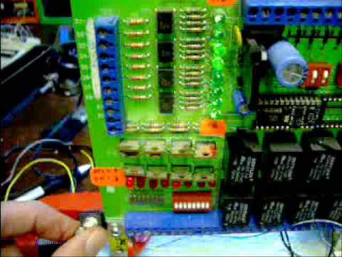

Heres one I did using the BS2 and a potentiometer-style encoder ( 100 pulse per rev, I believe)
