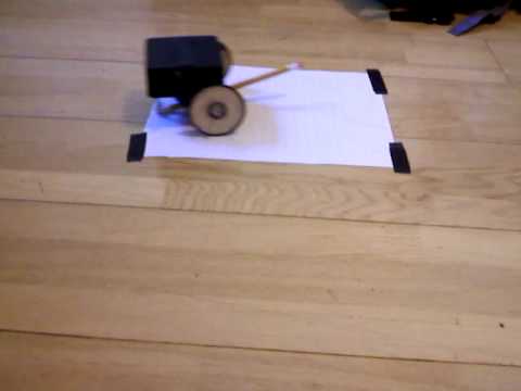

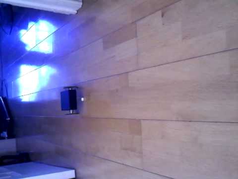

    oops, i guess i wasn't very clear, i am working with a propeller. am trying to write a program in assembly that can be used with only knowledge of spin. so far i have 3 functions, straight line, zero radius turn, and circle, but i need to improve my ramping, i seem to always have some wheel slipping at the end. here are some videos of it working:
    here is a straight line:
    and here is my circle test, it isn't just a set speed on each wheel, it is calculating how far off from the circle it is and using different speeds based on that.
    my robot has excessive encoder precision at 9024 possitions per wheel revolution, so i am not sure how well my program would do with a lower precision system.
    edited 2009-11-17 00:39
