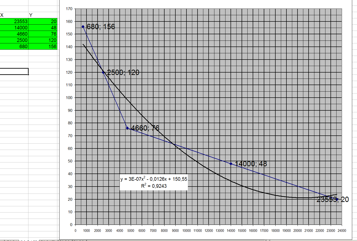

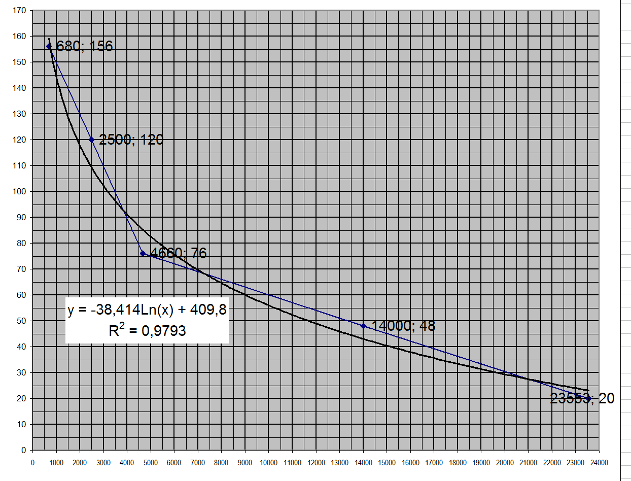

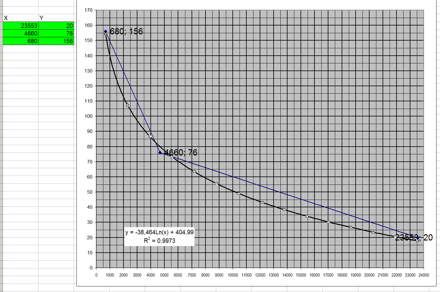

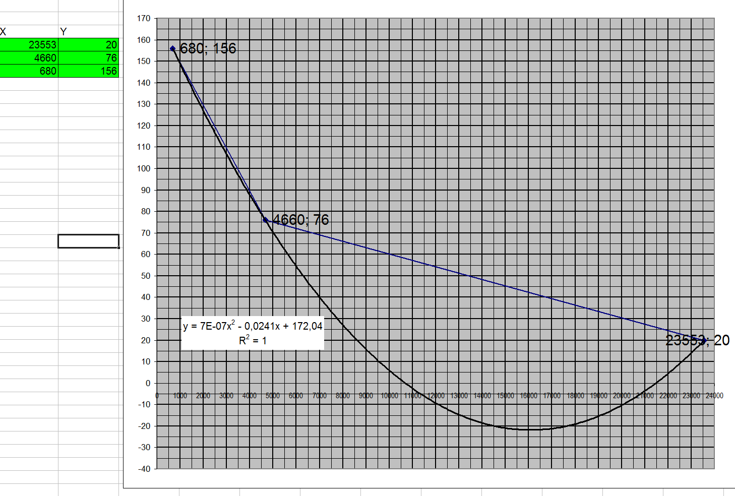

I did a graphical analyse and then you can see that it does not fit very well for values between the three given points.
The R^2=1 indicates the given points match 100%. But the deviatation for other values is big.
What I have learned about math is: never thrust a result until you have proven it with another method or a lot of experience.
If you add two more points the aproximation gets better.
You get a really good aproximation with a logarithmic function.
And what is really astonishing: I estimated two points inbetween
with the logarithmic aprox-function the three-point-version is closer than the five-point.
I think this is because my estimation set the point as it would be a linear function between each of the two points
The R^2 gives an information how good the aproximation is. A higher R^2-Value means a better aproximation.
The Float32-object provides logarithmic calculations
See attached pictures.
best regards
Stefan
Post Edited (StefanL38) : 11/10/2009 10:12:23 AM GMT

@StefanL38:
That last graph is what I was looking for all along, I guess those quadratic equations (I think that what they are called) don't cut it. The log-based equation looks like the way I have to go. I tested it out, and it looks very close to the values I was expecting. What program did you use to get those equations, graphs, and values? If I wanted to get new equations with new numbers (I expect I will need it a couple more times soon, and a few more times throughout my life -- that is an understatement), where could I get it? There is a lot less float computations that need to be made which makes it more readable and faster.
Next thing I am looking for is float log function that doesn't use PASM (no need to waste the cog for a 4 float computations every second). Log is the only one that I need that is not in the FloatMath object. Any ideas where I could get that? I guess I could port it, but that seems like a major hassle.

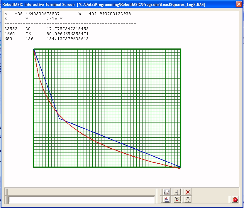

You are fitting the points to a Logarithmic (natural log) curve
y = a*Ln(x)+b
This is a Line formula similar to· Y = aX+b
So what you need is to fit your points using Linear Least Square Line Fit. But you are not fitting the
(x,y)…..rather you are fitting the (Ln(x), y)
Once you do the fit you will obtain the values of a and b
So now you know a and b and thus the formula y = a*ln(x)+b is defined.
Now remember when you do the Regression Analysis you must use Ln(x) and y [noparse][[/noparse]not x,y]
The formulas for the linear regression are
a = (sum(Xi)*sum(Yi) - n*sum(XiYi))/(sum(Xi)^2 - n*sum(Xi^2))
b·= (sum(Xi)*sum(XiYi) - sum(Xi^2)*sum(Yi))/(sum(Xi)^2-n*sum(Xi^2))
Remember the Xi in the above is actually Ln(xi)
So· the process is
1-····· Plug the values of Ln(X) and Y in the formulas above
2-····· Step 1 will give you a and b.
3-····· You now have the curve y = a*Ln(x)+b
Here is a program in RobotBASIC that does the above work and ALSO...it plots the data.
Again...just an Engineer's program...no Frills and Whistles.....you can do that yourself if you need to.
//-----enter your data here data x; 23553.0, 4660.0 , 680.0 data y; 20.0 , 76.0 , 156.0 n = maxdim(y,1) //----do sums SumX = 0 \ SumY = 0 \ SumXY = 0 \ SumX2=0 For i = 0 to n-1 SumX = SumX+NLog(x[noparse][[/noparse]i]) SumX2 = SumX2 + NLog(x[noparse][[/noparse]i])^2 SumY = SumY + y[noparse][[/noparse]i] SumXY = SumXY+NLog(x[noparse][[/noparse]i])*y[noparse][[/noparse]i] next a = (SumX*SumY - n*SumXY)/(SumX^2 - n*SumX2) b = (SumX*SumXY - SumX2*SumY)/(SumX^2-n*SumX2) //----print out the data print "a = ",a;"b = ",b print "X";"Y";"Calc Y" print sRepeat("-",50) for i=0 to n-1 data yy;a*nLog(x[noparse][[/noparse]i])+b print x[noparse][[/noparse]i];y[noparse][[/noparse]i];yy[noparse][[/noparse]i] next //-------generate graphs original data but also a smooth claculated curve i = min(x) \ h = (max(x)-min(x))/30 while i <= max(x) data xx;i data yyy;a*nlog(i)+b i = i+h wend data GPSpec;100,130,500,400 data GSpec;100,130,500,400 mGraphPaper GPSpec mPlotXY GSpec,x,y GSpec[noparse][[/noparse]4] = 4 \ GSpec[noparse][[/noparse]5] = 2 mPlotXY GSpec,xx,yyyHere is the printed output from the program....the graph is shown in the Jpg attached
a = -38.4640530675537······ b = 404.993703132938
X······ ·· Y······ Calc Y
23553·· 20····· 17.7757547318452
4660··· 76····· 80.0966656355471
680···· 156···· 154.127579632612
Post Edited (SamMishal) : 11/10/2009 8:37:31 PM GMT

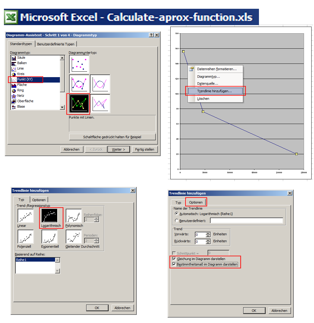

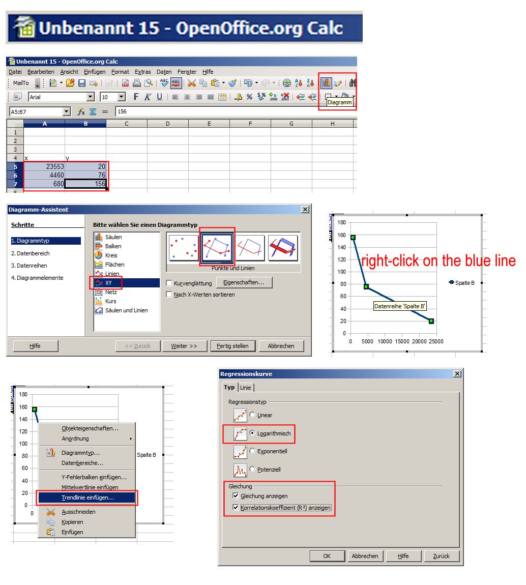

big smile on my face: I already mentioned with which program I did that.
Even bigger smiling: And I bet you already have it.
Almost nobody uses Microsoft Excel or OpenOffice Calc that way
This is simply a X-Y-Diagram created with Excel (OpenOffice Calc will do the same)
with a added trendline with activated option show trendline equation
see attached picture. As I'm from germany I don't have an eglish-speaking Excel handy
but I think the symbol will guide you how to do it
Sam shows how to do it in Robotbasic
best regards
Stefan

(by the way: to all the helpfile-authors:
screenshots showing the COMPLETE clickway is what is missing in 99% of all help-files
