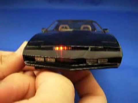

How would I get it to then cycle back from pin 4 to 9 and then start over?
I'd like for it to end up looking like KITT (
)Thanks for reading

PUB KITT dira[noparse][[/noparse]9..4] ~~ outa[noparse][[/noparse]9..4] := %100000 repeat repeat 5 waitcnt(clkfreq/10 + cnt) outa[noparse][[/noparse]9..4] >>= 1 repeat 5 waitcnt(clkfreq/10 + cnt) outa[noparse][[/noparse]9..4] <<= 1Edit... where are my priorities? ... heck, I wish I still had that car!

I loaded your program and it worked, and I would like to ask why you put the number next to the nested repeat commands. Is this so that it had a finite amount of times to add 1, before it executed the next repeat loop? And then it went to the other direction for a finite about of times, and then started over?
Thanks again btw, this made my night! Think it'd be sacrilegious to have KITT lights on a Toyota?
