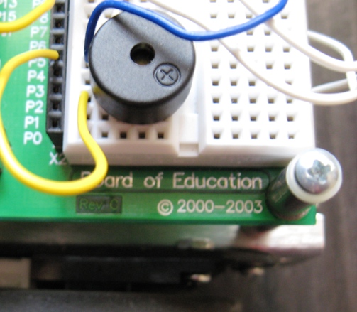

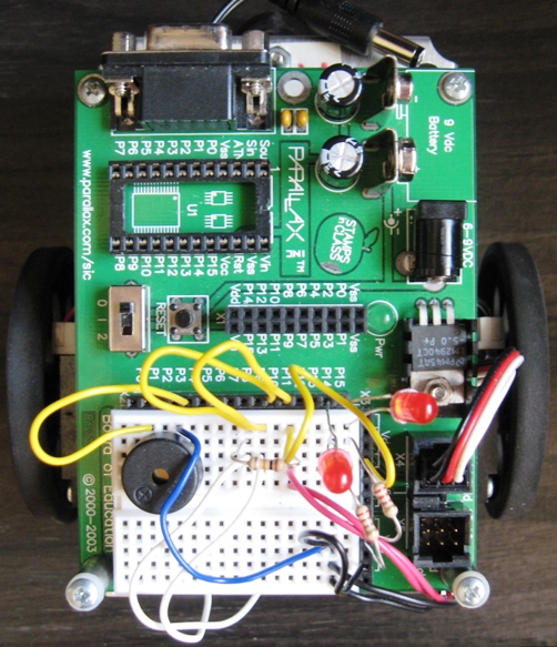

    Since you have the USB-BoE, did you mount the 1k resistor between
    pin2 (SIN) and pin4 (VSS) of the DIL24 socket on the solderside of the BoE board?
    Without it the javelin might not be recognized. The MUST-READ thread I posted
    few posts back explains why.
    If that doesn't resolve the issue, you·should contact Parallax support
    for a replacement.
    regards peter

    Hi, Peter may i know if USB-Boe means that the Board-Of-Education comes with USB connector? cos mine actually dont but it is RevC. So do i insert back pin24 after soldering the resistor?
    I hv attached pictures of my boe. Will Bs2sx module works with the soldered resistor if i wish to use back?

    Hi peter, i am able to detect the Javelin Stamp already, thanks. I inserted back Pin24 and had the resistor before i can detect it. However, the Javelin stamp starts to get real hot with pin24 inserted in.. Will it cause any problem?
  • Peter VerkaikPeter Verkaik Posts: 3,956
    edited 2009-09-30 06:40
    You can leave the resistor in place. You can go back using BS2sx with resistor.
    The javelin does get warmer than a BS2sx but that is normal.
    If you can detect the javelin now, as you say, and you can download
    programs to it, I think it will be ok. Conclusion must be that there was
    a bad contact between javelin pins and socket pins, that is resolved
    by the multiple chip insertions.
    regards peter
