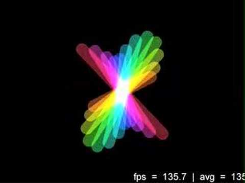

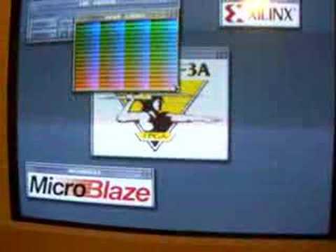

    This demo is of graphics done on an FPGA (it's wise to grab the slider and fast forward through rather than sit through it):
    http://www.youtube.com/watch?v=Z8bfXVOExXo·(D/AVE, http://www.altera.com/support/examples/nios2/exm-tes-demo.html)
    I have no idea how much this particular·IP core costs, but suffice to say this video shows that·something like this·is possible without using mainstream graphics chips.
    Another, which I think is open source:
    http://www.youtube.com/watch?v=RttajqhNpzw
    http://www.frank-buss.de/yagraphcon/index.html
    Whatever mechanism you use, the problem then is how to get image bitmaps to the screen. This is still going to be a bottleneck whatever way you go. The less Prop pins you use, the more of a bottle neck it will be. The YaGraphCon demo shows speed over USB for example.
