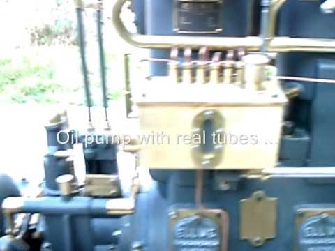

I have built this engine from a set of castings:
<http://www.motor-manufaktur.de/ellwe/pics/ellwe_2fb_m10.JPG>
The seller of the castings was astonished when he first heard my engine. His sounded like a bunch of cans torn behind a car ("Just married"), mine sounds like this:
No, in the beginning, that's one of my cats!

Naaa! You have no idea how an IC-engine has to sound! First of all, Stirlings are are no ICs, so they fail completely. Second, the sound is coming from the intake and the exhaust. The rest is noise. And I don't want noise, I want SOUND!
There are a few tricks how to build a muffler that sounds good.
Sorry for OT!
Nick
Never use force, just go for a bigger hammer!
