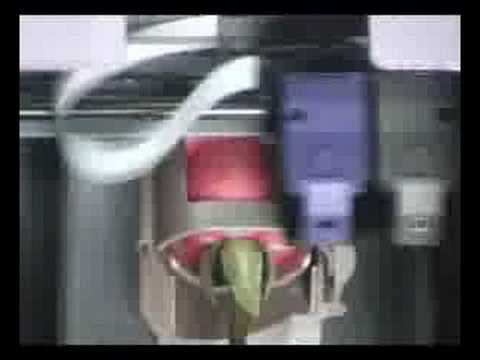

    Here's a video showing the basics: http://www.youtube.com/watch?v=K4jkOITEUHA
    It isn't printing anything in this one but I'll upload one that does once I finish the design.·
    If someone else wants to partner to make the pcb, we can reduce the price down to $110 just for the x axis assembly and inkjet holder.· Salvaging them out of old printers, cleaning·and testing them is pretty manually intensive task.
    I'll upload more pics and videos to my site once I have the chance to create the webpages.·

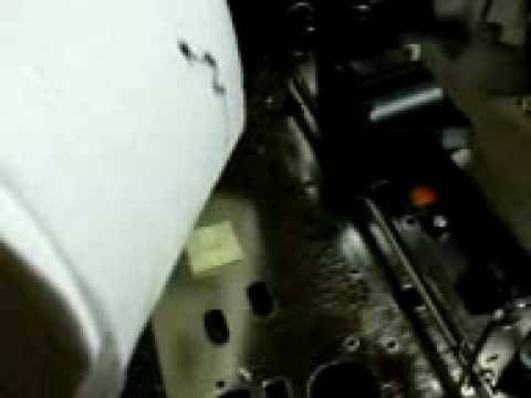

    Here's a new video showing the ink ejection:
    I use a 4.5us pulse and a 1ms delay between ejections. You can see it's almost a constant stream.
    The code is very simple but I had to write it in assembly because the BS2 spin functions had around a 20us minimum time with waitcnt.
    Instead, I wrote a decreasing loop compare that burns 89 instructions (4 clock cycles each) and verified it's exactly 4.5us on the scope.
    There's probably a more elegant way to do this so if anyone knows of a spin object with 1us pulses, let me know! Also I just took the first assembly example from the manual and modified it a bit. Once I have a bit more time I'll look at it more carefully to make it more elegant.
    I'll put the circuit up along with the source code to my site this weekend.
