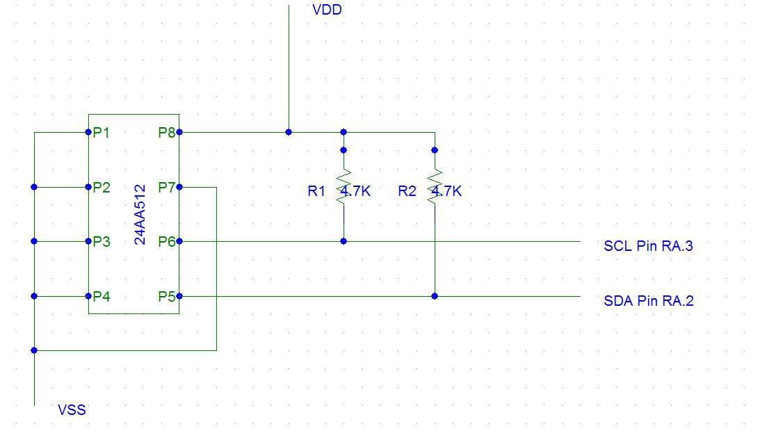

I am relatively new to SX.· I have a SX48 protoboard that I have sucessfully programmed some functions that work.· The problem I'm having is I can't get I2C EEprom working. All I get back is garbage. I've attached file of how I2C is connected and the program file.· Hope its something simple.
I am running at 75MHz because this will eventually be a data acquisition program.
Ben

    Do you really want the I2CSPEED to be 0.01 ?
    That might cause a problem at high clock speeds.
    Try removing that line.
    Bean

    I would avoid using locals, too, as this adds processing overhead and time to do things. You can change I2C_IN to this:
    FUNC I2C_IN
      ackNak = __PARAM1.0
      I2CRECV SDA, __PARAM1, ackNak
      ENDFUNC
    ... and if you make "flags" the first byte in your variable list it will be global, even in the SX48.
    And I agree with Bean; based on the spec sheet lowest I2CSPEED setting you can legally use is 0.125 (~400kHz) -- I think you missed a decimal point.

    I took out the I2CSPEED but I still get garbage.
    I was using locals to keep from using all my variable space but will try taking local out of I2CRead.
