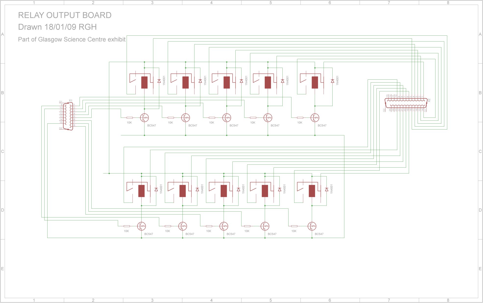

Well now, I'm quite aware of how ground loops and spikes can cause trouble. This prop controls a set of relays through standard npn transistor drivers; all relays are provided with clamping diodes, of course. The other ports on the prop go to serial ports or are inputs switched by phototransistors. As far as I can see, there's nothing in this design that could cause a problem of this sort, the unit has been operating continuously for about three weeks, yet this has in fact happened! I've been reading around the forum on PLL failure and as you say there's a fair bit of info there.

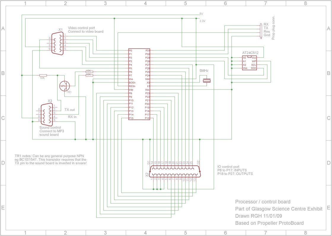

Carlos, would you happen to have a diagram or photos of your layout because it would be worthwhile gathering information about these board failures.
Is there an any diagram showing the copper layers on the protoboard, anyone?
*Peter*
Diagrams attached (relevant parts). The processor board is a proto board, I just reproduced the essential parts of the diagram here.
I'm afraid these diagrams may not be too clear as there at first glance does not seem to be any direct way of connecting them. That's because there is a loom which goes from the 25 way plug on the processor board and the 15 way plug on the relay board, and this isn't shown here.
Also, the relay board has a power plug supplying the relays separately. Nothing is supplied directly from the proto board.
I'm thinking that I am going to rebuild this processor board separately using a 40 dip prop, that way I can swap the chip out if it goes bang again.
