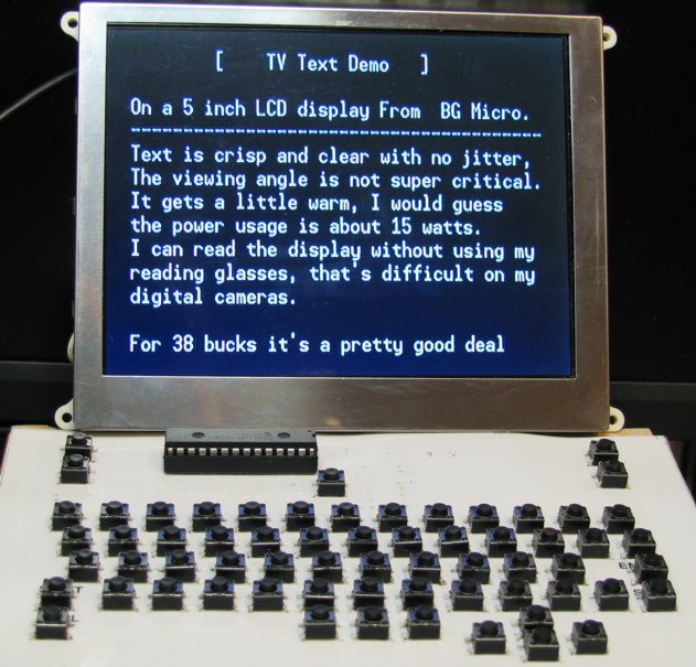

I think the displays are used, there are minor scratches on mine.
If the resolution were 640x480 it would be prefect.

I thought the same thing too, till I noticed that the screen has one of those sticky clear films covering it

I notice in your photo, around the edges of the image area, it appears to be just plain black.· Mine seems to have bands of color in the boarder areas.· I also notice that your white on black looks better than mine.· The only combination I got to look good was black on white back ground.· I suspect I am not programming the display call correctly though.· By chance, would you mind posting the code for yours so I can explore a bit more about it?

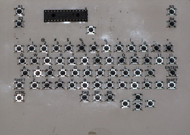

the code is just a modified version of "TV Text Demo v1.0" It's a serial keyboard, the chip is a Picf18xxx using the internal oscillator, sure wish I could find a 8x8 keyboard that size,
like those used in language translators/dictionaries.
Post Edited (Bill Drummond) : 3/16/2009 4:13:03 PM GMT

note: if the wall wart doesn't supply enough current the display will shut itself down after briefly turning on. Fat pixels = fat wall wart.
I did the graphics with Corel Draw. It's wired with 30ga wire and I ain't showing nobody the bottom side.
