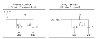

I'm building a few hardware howtos for my new project boards. The boards support a potentiometer, and I'm wondering what the 'best' or most common way is to read potentiometers.
I'm familiar with the Prop, and reading a potentiometer with the prop is a 1 pin job (I've attached a screenshot from the tutorial). Just an RC decay circuit.

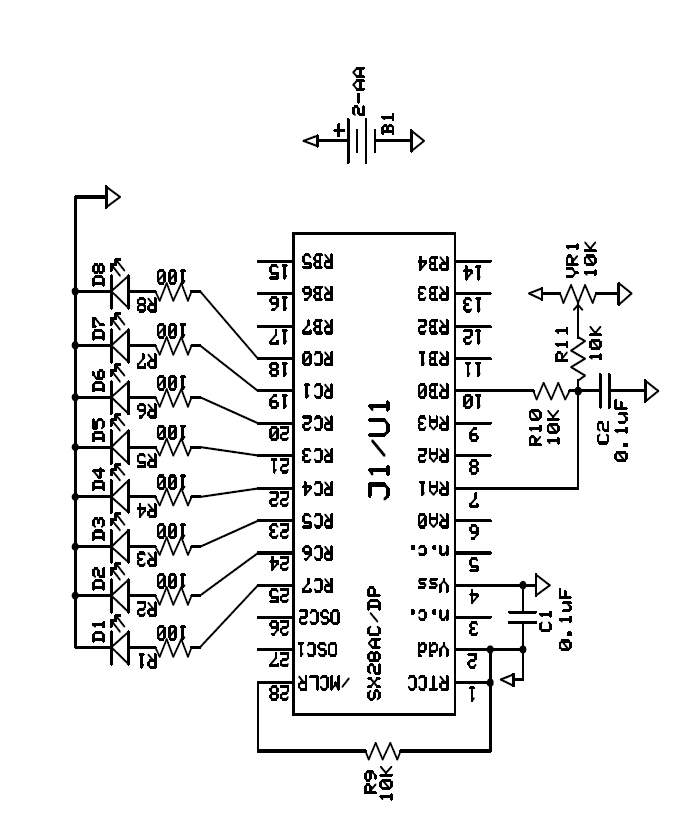

But I'm not familiar with the SX. Looking at bean's Cylon Lights, he uses 2 pins (Schematic attached). Is it the case for the SX that reading a pot is a 2 pin job, or bean's circuit atypical?

    Nick,
    You can do it either way.
    The 2-pin method on the SX (AnalogIn command) returns a value depending on the VOLTAGE, the 1-pin method (RCTime command) returns a value depending on the RESISTANCE.
    The 2-pin method always takes the same amount of time to get a reading. With the 1-pin method the execution time is dependant on the resistance being measured (and can take quite a long time if the resistance is high).

    Something I'll add ... reading a VOLTAGE will provide a linear response, while reading the RESISTANCE will provide an exponential or logarithmic response which can lead to decreased sensitivity.

    Right. Now it seems obvious to me that bean is using the Pot as a voltage divider and doing ADC to determine the position of the knob. Sounds like I should do a mini-howto on doing it both ways. Some designers might want the extra pin, and some might want better accuracy / faster readings.
