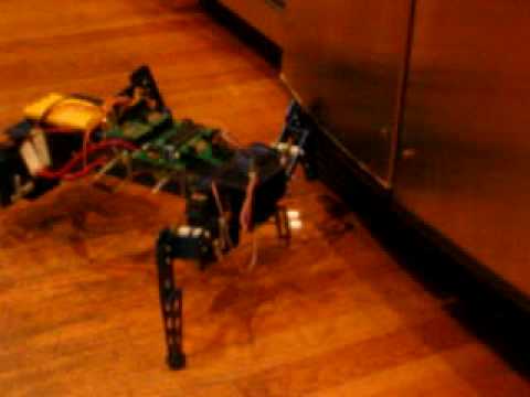

    I am glad you brought this up, because I have been puzzling over inaccuracies in Ping sensors as well. I have a ping sensor mounted on a servo of a small walker and while it is often accurate, it sometimes is wildly off. You can see what I am working on at: [url=http://
    One problem I have notice is that the Ping sensor is that it isn't a very tight "beam". I have never found any information on the angle of the cone of sound coming out of a Ping. In general though you do not want to mount it so that it points parallel to a close wall or floor.
    Is there anything special about using a Ping sensor with a prop that could cause it to be less accurate in some cases, either due to the controller timing or the prop I/O? I did not experience as much of a problem with a basic stamp. On the other hand, I never tried to sample as often or as fast with a Stamp.
    Any experiences or advice in using a Ping with a Prop would be very helpful.
