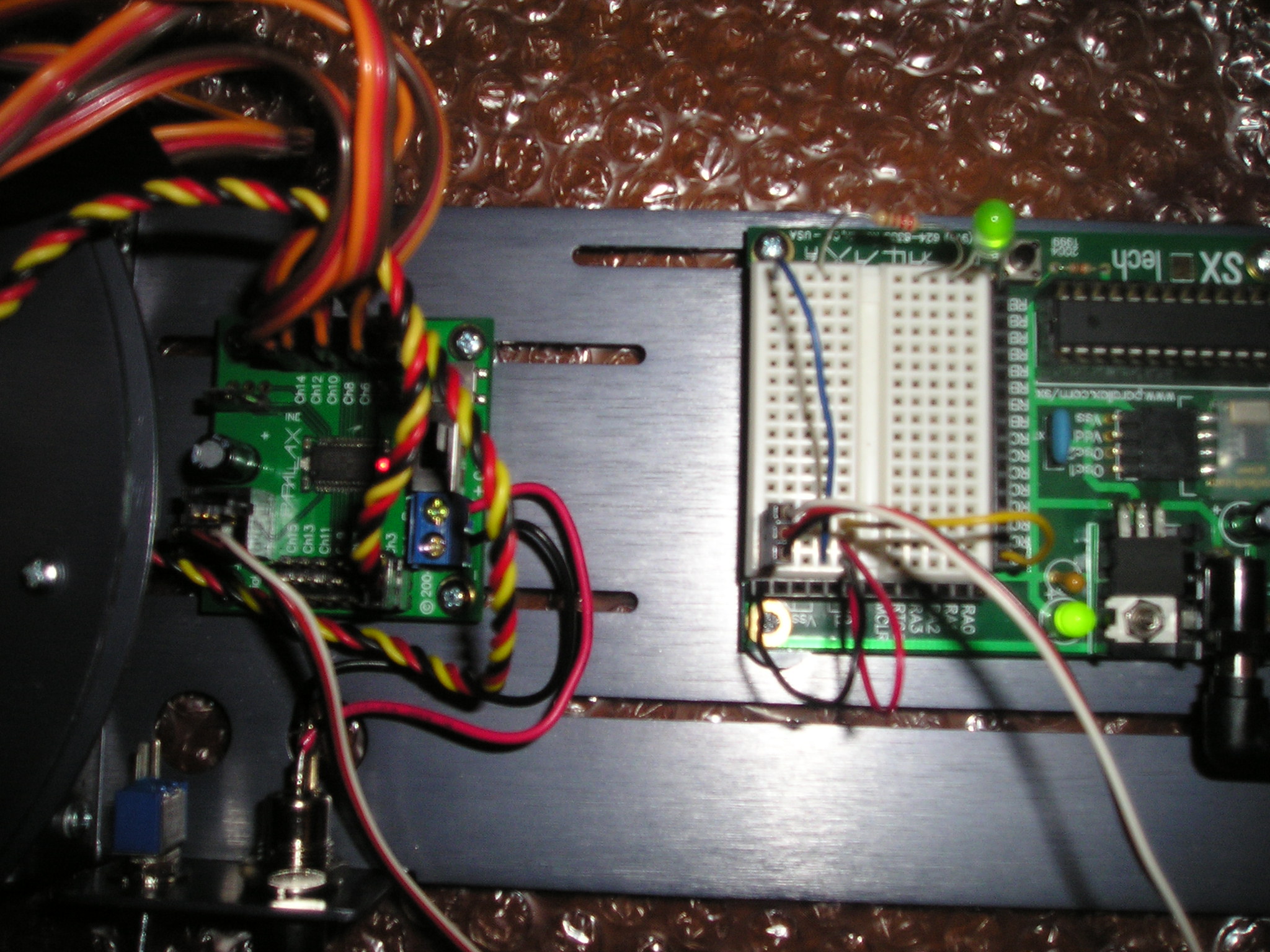

Dear All ,
Iam working on the PSC but using the SX 28 MC and SX tech board.
The documentation and code examples for PSC is based on BS2 MC.
To communicate with the PSC and set the position of a servo·the documentation states the following·:
Position Command – Set the Position of a Servo Channel
Syntax: “!SC” C R pw.LOWBYTE, pw.HIGHBYTE, $0D
Reply: none
C· : is the servo channel
R : is the ramping value .
PW : is the position value.
and the code i used is· :
SEROUT Sdat, Baud,[noparse][[/noparse]"!SC", 0, 15, pw.LOWBYTE, pw.HIGHBYTE, CR]
The command string is 8 byte long ending with "CR" .
the Baud value is 396 corresponding to speed 2400 which is the defualt for the PSC.
The code runs properly in BS2 and the servo responds to position commands.
I tried to do this using SX/B and used the following code :
PW·········· VAR· WORD
PSC········· PIN· RC.7
ServoCmd· VAR· Byte(8)
idx··········· VAR Byte

· I can think of several things that might be the problem.
··Make sure you are NOT using the internal oscillator (OSC4MHZ on the DEVICE line), because the internal oscillator is not accurate enough for serial communications. Use a resonator.
· Put the output pin into the correct idle state before sending the data. Use "HIGH PSC" "PAUSE 5" right after "Start:".
··Try to send a zero byte before the "!SC" command.
· P.S. Please post the entire program. That will help us help you.
Bean.

I did the changes you·suggested , but no results at all .
Iam attaching the whole program code , and a photo for the conenctions.
I assume you are using a 4MHz resonator ?
The only thing I see that might help is to change OSCHS1 to OSCXT1.
OSCHS1 is for higher frequencies (like 20MHz).
Also if you are using the USB SX-Key, use Run->Clock to set the key to 4MHz. Usually you only have to do this once until you quick the SX-Key IDE.

I found the problem.
Using an oscilloscope, I checked the serial output signal from both boards SX & BS2 and found that the signal from the SX board contains lots of noise , while the BS2 signal is almost perfect square signal.
I traced the voltage supply and found it noisy on the SX and DC stable on the BS2.
I added a 100 uf·capacitor on the output of the voltage regualtor , and checked the output signal from the SX board and the result was great , almost a perfect square signal.
i connected the PSC and the motors roared· [noparse]:)[/noparse] .
Thanks for your valuable tips.
