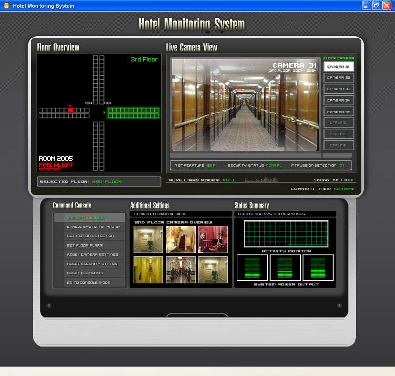

    I am looking for an option to put video cams inside residential rooms and exterior as well, plus businesses, etc, so that someone can monitor either on site or off site (by net) any cam they choose. If monitoring locally, the cams would have their own set of lines on an RS485 cable where the master can pick any cam by ID and read it's current state at some still frame rate allowed by 9600 baud. Higher baud may likely be achieved, as is claimed by RS485. There is no real need for video speeds. If I can get 1 image per sec (several seconds) that is good. Another thing I want to try is using the Xtend systems to broadcast the images, so the user has a handheld unit with LCD (maybe oLED 128) to monitor any cam.

    TChapman,
    Notwithstanding the privacy implications, have you done the math? 9600 baud is about 960 bytes per second. Translated into frames, with an absolute minimum 4 bits per pixel (grayscale — no color), that's 1920 pixels per second, or a picture size of 52 x 37 pixels, at one frame per second. At that resolution, you won't see much anyway.

    No Phil, I don't know much about how the math works out, just looking into. Below is a mockup I had done that may help illustrate the concept for the cameras. For security reasons, users can put cameras however they want, that is not really my concern. I believe that with RS485 there will be much better baud. When I get the boards back I can test the baud possibilities at various wire runs.
