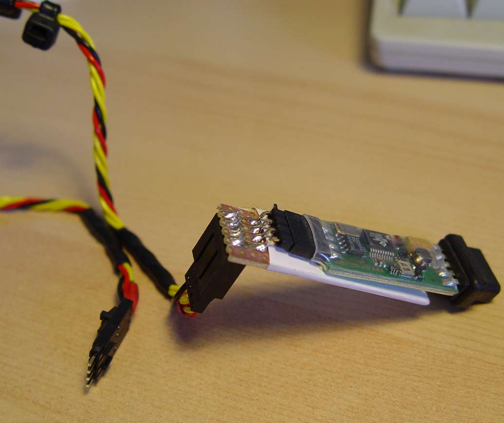

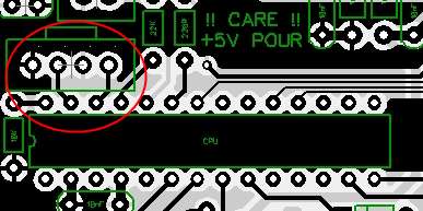

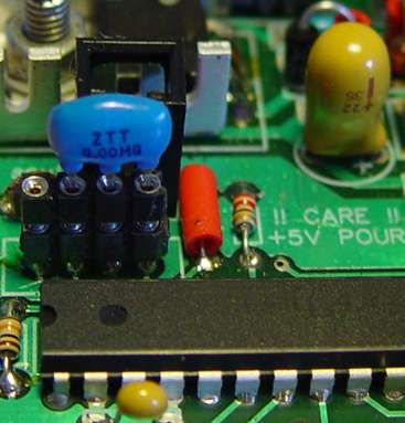

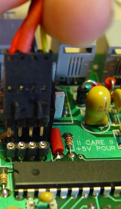

    This is how I did it on a pcb once... photos attached. This designed enables the programming port and resonator to share the same place on the pcb.
    You can see the resonator is soldered into a 4-way sil header, which then plugs into another 4-way header that is soldered onto the pcb. That same "on-board" sil header is useful for holding our modified programmer pins against. It means "in the field" you can unplug the sil with the resonator in, hold the programmer against the pcb header pins to reprogram, then plug the resonator back in. You can also replace the resonator easily should that be necessary.
    The programmer pin adapter was necessary as the SX-Key pins are in a different order to the resonator.
    Also, you could just plug the resonator directly into the first sil row, without soldering it. It seems to also be stable, but I am not sure how vibration-proof that may be in the long term; depends on your application I guess... The double sil thing just seemed a bit "stronger".
    One note is that you may not be able to debug if the cable length of the homemade adapter is too long, although for programming the devices the sx-key is very tolerant and 50-60cm is fine (as with my creation). If you do need to debug with this method, you will want the cable absolutely as short as possible.
    Best of luck, Max.
    Edited: Although it might be obvious, the pin connections on the 4-sil pad ringed in red on the pcb image are: (left-to-right) 5v - osc1 - gnd - osc2. PLEASE do not mix up those connections!

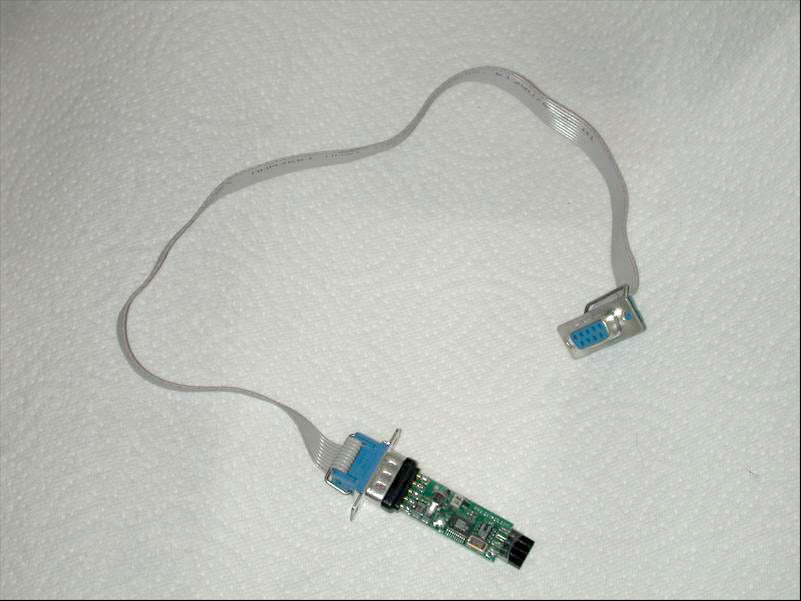

    It's a good idea except for the cable length that Max mentions. When debugging at high speed (say 50 MHz), the SX-Key is sending a 50 MHz clock across that extra set of headers and cable, adding capacitance and potentially causing the entire thing to not work. This is a particular problem when trying to debug.
    A far better solution with a serial (not USB) SX-Key is to plug the SX-Key into the board it is controlling, but create a ribbon cable based DB9 connector to connect it to serial cable plugged into the PC. The fear most folks have is the weight of the bulky serial cable pulling on the SX-Key and the header it is attached to. A ribbon cable adaptor will put little to no strain on the SX-Key, nor will it cause electrical problems since it is simply carrying the serial communications between the PC and the SX-Key.
    Buy a piece of ribbon cable and two IDC style DB9 connectors and you're set.
    Here are the two examples of connectors I am talking about:
    www.mouser.com/Search/ProductDetail.aspx?qs=vjnyqxV37zV5teAQnFeGVQ%3d%3d
    www.mouser.com/Search/ProductDetail.aspx?qs=MS1VvQIQhGdHth2aLs5spg%3d%3d
