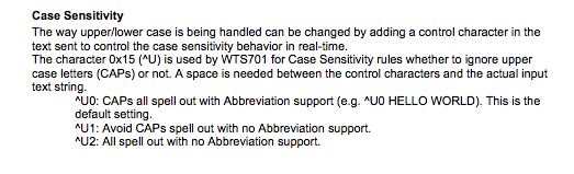

Emic module pronoucing alpahabet instead of speaking the word
I suceeded in making my emic module talk. Whenever I send a single word, it converts the word to speech. But when I send a sentence, it pronouces each letter of the sentence and converts the last word of the sentence to speech, not the others. What have I done wrong?

Cat is spelled CAT
will speak
"cat is spelled see ai tee"
I learned this the hard way last year. Undocumented feature.
However, after a bit of work, I tracked down some documentation for the (now obsolete) Winbond TTS chip used in the Emic (and the Devantech SP03).
Turns out you can slip control characters (like the ^p for phoentics) into the serial byte stream to control what happens in case of caps, abbreviations and the like:
