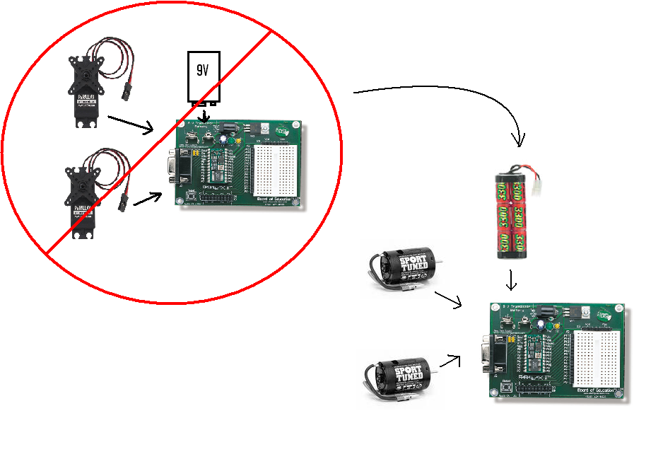

·Ok, so apparently, just to swap my servos for rc car motors, I need a motor mind B? Do I need 2 or just one? It's really simple, I just want to swap the servos! But to run these motors, I would need to run a rc battery through the board right?·Is there another route?

Another possible solution is to purchase sail winch servos from a big box hobby store. Sail winches have lots of power, however, they are slow. They are intended for RC sail boats.
Are your interest in speed and or power and or position control and or school project and or just for fun?

If memory serves, the ESC takes servo-style pulses from the RC receiver (which are servo pulses) and uses them to control the motors.· I'm not sure if they can drive two motors in different directions though, for tank-style steering.
They vary wildly in quality and price, so start with a local hobby shop and look around.

There is no simple solution to what you are asking.
What would be really cool, cheep·and challenging is to purchase the Parallax wheel encoders·http://www.parallax.com/detail.asp?product_id=28107 and have the BOE-BOT perform controlled precision maneuvers on a hard surface. You will gets lots of support form Parallax·http://www.parallax.com/dl/docs/prod/datast/ApplyEncoder.pdf and learn some advanced math.· Now that’s an A+ project. It is all right there on the Parallax sight.
Anybody can make a robot go fast. Try to make an articulated robot dray a straight line. Now that a challenge.

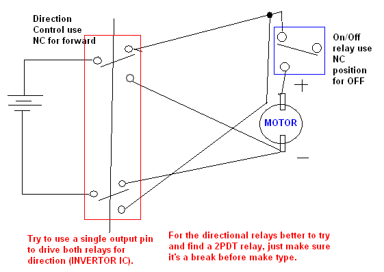

made a pic
oh, keep in mind you may need a couple of switching transistors to drive the 12vdc relays, depends on what kind of relays you can find. I'm sure you'll need pullup resistors though if you find relays that are controlled by 5vdc and can allow the right voltage to drive the motors.

personally I would go with the optoisolators.
