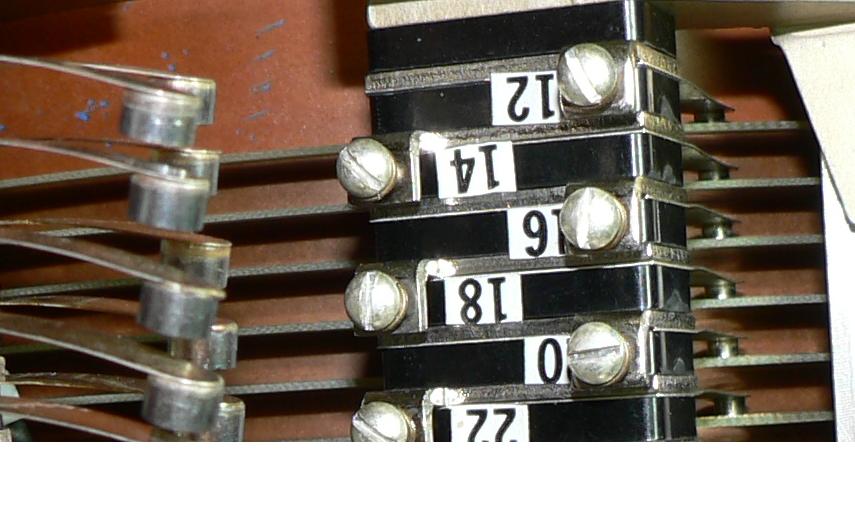

  • steve_bsteve_b Posts: 1,563
    edited 2007-08-13 18:09
    We use contact brushes to pass electrical signal from a rotating radar dish down to a computer.
    The brush force is crucial in how long it will last....too hard and it'll wear out fast...too light, and it'll eventually wear enough that it'll have intermittant contact.
    We played a little bit with a flexiforce sensor and had a terrible time getting repeatability with measurements.
    The sensors require "pre-loading" to "condition" them so they will read. I think the sensor is basically a gel capsule with some resistive gel inside. You preload it so that the gel spreads out uniformly.
    Anyhow, we eventually gave up on using it for a brush force sensor. It would be fine for a relative reading but not something fine and exact!
    edited 2007-08-15 17:23
    Hi Craig,
    I ended up getting busy with "real work" hehe I was playing with the flexiforce sensors in hopes of rolling this out to other techs as an easy solution to knowing the brush pressure (they could just put their multimeter on the leads and they've got an equivalent reading).
    The area I need to get in to is VERY small (see attached) so the flexiforce was idea in that respect.
    *(in the pic you can see how the brushes come with a pre-bend in them..)
    Anyhow, if you have a fairly large area to get under, you might like at a piezo type force sensor (I'm sure there's one available from parallax) just be sure to build the suggest 'protection' circuit as the instantaneous voltages can be somewhat large (not much current though).
