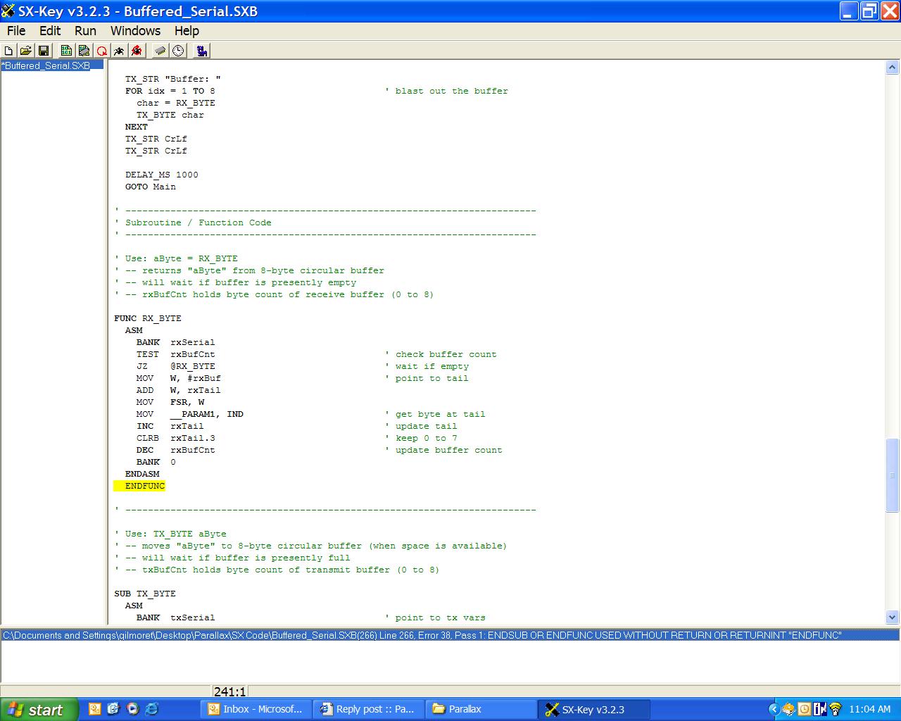

    JonnyMac,
    When attempting to compile I got an error. See attached jpg screenshot.
    1280 x 1024 - 126K
  • BeanBean Posts: 8,129
    edited 2007-08-10 15:31
    You are using the BETA compiler.
    You'll have to add a "RETURN __PARAM1" before the ENDFUNC to satisfy the compiler.
    Bean.

  • JonnyMacJonnyMac Posts: 9,447
    edited 2007-08-10 15:44
    Terry,
    Is that because the compiler expects the FUNC keyword to have an associated RETURN? I'm using 1.51.03 so I have not see the problem reported by T&E.
  • T&E EngineerT&E Engineer Posts: 1,396
    edited 2007-08-10 16:01
    That did it for me:

      [b]RETURN __PARAM1[/b]
      ENDFUNC
    edited 2007-08-10 16:31
    JonnyMac said...
    Terry,
    Jon,
    · Yes, it is expecting to see a RETURN somewhere within FUNC...ENDFUNC (I'll have to change the wording of the error message since it references ENDSUB which CAN be used without a return).
    · It probably should be a warning instead of an error, since it doesn't prevent anything from compiling.
    Bean.
