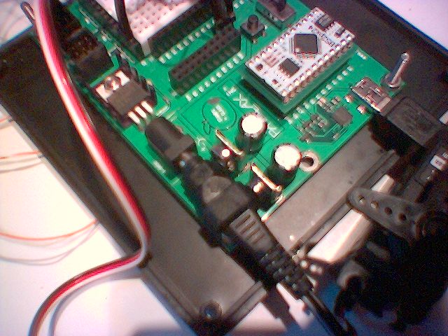

    Is there realy nowone that can help me to program the PWMPAL in order to get steady pulses for the servo?
    the technical info about the PWMPAL is scarse and not correct I think or is it me?
    I'm in the dark here....

  • imported_Daniimported_Dani Posts: 22
    edited 2007-07-17 22:33
    AlanLane5,
    Thanks for your input. It is not news to me though about the capabilities of the PWMPAL, after all that is exactly why I'm using one.
    To All the wise engineers:
    First of all, I apologize to all you gents for my fuzzy description of my problems with the PWMPAL. I didn’t explain a thing...idea.gif
    Thought that by asking for an example program I would find out what I was doing wrong. So far I found that it wasn’t me. cool.gif
    The problems I see are not caused·by my inexperience but by the PWMPAL itself.
    When I connect a scope to f.i. (P12) of·my BS2PX·I see intermittent pulses. It should give out 1500 µS·but gives 1503 µS·in general.
    I can live with that. But when I enable a counter or·second pulse channel (P13) the channels give out 1503-1528·µS·randomly·leaving me with·the most terrible servo performance. It moans and crunches end wants to run out to the left or right depending on the random fluctuation of the pulse.
    To me it seems that it's leaking parts of pulses to other channels. But than again I could be doing something wrong...
    So please anyone with PWMPAL experience, hop in this message and spread your wisdom…
    Thanks
    Daniël Komkommer
    edited 2007-07-18 14:26
    allanlane5,
    I have a BS2PX and a PWMPAL directly on a USB-BOE. 2 parallax continues-servo's directly to the P12 and P13 of the BOE.
    The powerunit is 300mA 9 volts from parallax.
    Everything is connected to one power supply and the servo's·have a cable length of 20cm.
    Now when I connect a pulse measuring device, also 20cm cable, and only 1 servo on the·BOE's·P12 without hardware control the pulse is good about 1500uS. When I enable hardware control and/or a counter·on that channel or any other channel P8,9,10,11 for that matter, the pulse is bad...
    I'v measured P12,13,14,15 with or without hardware control and/or counters and every time I have a irradic pulse. So what do you say????
    (Picture is of the BOE, BS2PX, PWMPAL and 1 servo)

  • allanlane5allanlane5 Posts: 3,815
    edited 2007-07-18 16:32
    Hmm. I'm pretty much out of suggestions at this point. The symptoms look like the PWMPAL and the BS2 might be 'fighting' each other, since I believe you do have a BS2 pin and a PWMPAL pin at the same place, the BS2 pin should probably be set as an "INPUT" to allow the PWMPAL pin to control the Servo.
    The big difference between the BS2 and the PWMPAL is that the BS2 doesn't have to 'refresh' the PWMPAL. If you ARE 'refreshing' the PWMPAL, it's possible your refresh is interferring with the PWMPAL's control of the servo.
    Otherwise, it looks like your grounds are all connected, everything is correct. 300 mA seems low for more than one servo, so it's possible your Vdd is 'browning out' -- but you'd get a much more obvious symptom than a 'long' pulse should that happen.
    I guess I'll have to leave it to Parallax at this point. Probably they haven't stepped in so far to give you and I a chance to work it out for ourselves.
