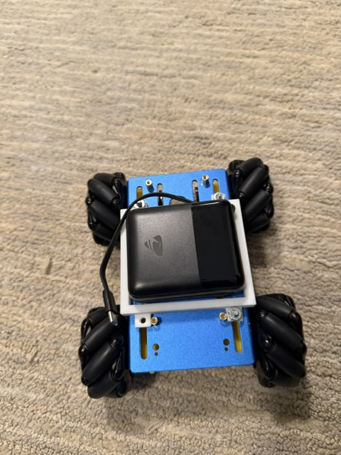

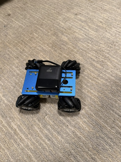

    3D printed a corral for the battery pack and got it installed. This was a pain, should have installed these things BEFORE the motors, but oh well...
    The plan was to use two of these battery packs, one for motors and other high current stuff, and one for the P1 and it's accessories.
    But, guess going to try single supply. Not exactly sure how much power this pack will put out. Could be 3A and then all would be OK.
    But, might be 900mA and things might get dicey...
    480 x 640 - 159K
    480 x 640 - 185K

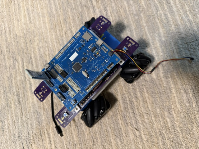

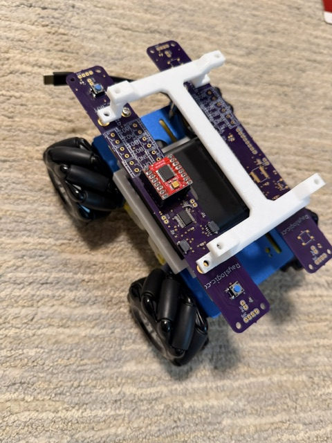

  • RaymanRayman Posts: 16,427
    3d Printed a fixture for holding the P1 Platform3 PCB at the top of the robot. Seems like it will work, just need to find some more screws...
    Think the bones are all together now, just need to wire it up...
