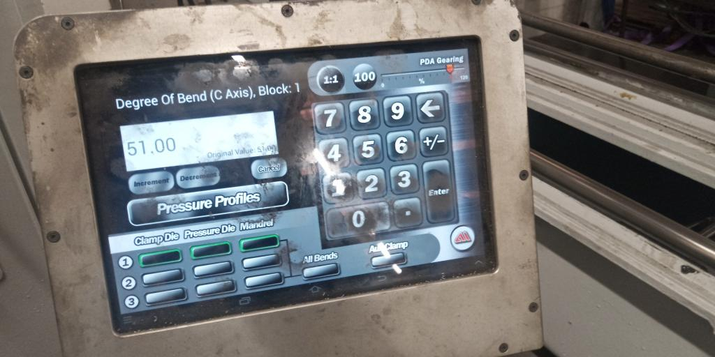

    The front-end receives constant physical abuse; it dies and the machine manufacturer doesn't support it anymore....a $200,000 piece of equipment is dead because of a HMI.
    This is a retrofit I did in 2015, it's a standard Samsung Android tablet that is totally abused, never even wiped down. Even with that dried-on gunk and metal chips on the screen, it responds like a brand new unit. If it dies, they simply download the app to a phone or another tablet, pair the Bluetooth and they are back-up and running.
    The younger machine, next to this, has a Siemens HMI that is unusable due to dead buttons and joystick (mouse). In this case, I WILL replace all nine drives/motors because I refuse to even look at Profibus but it will still be a drop-in-the-bucket compared to a new machine.
  • Very nice👍
