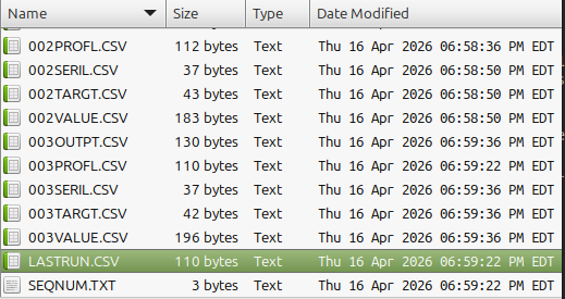

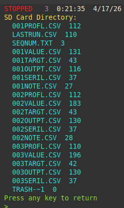

  • correct filesystem timestamps, from my rtc, onto files is nice.
    PRI syncFsClock() | tc, dc
        '' Push DS3231 RTC time into filesystem clock so file timestamps are correct
        tc := rtc.time_code()             ' $00_hh_mm_ss BCD
        dc := rtc.date_code()             ' $00_yr_mo_dt BCD
        fs.setDate(2000 + rtc.bcd2dec((dc >> 16) & $FF), rtc.bcd2dec((dc >> 8) & $FF), rtc.bcd2dec(dc & $FF), rtc.bcd2dec((tc >> 16) & $FF), rtc.bcd2dec((tc >> 8) & $FF), rtc.bcd2dec(tc & $FF))
