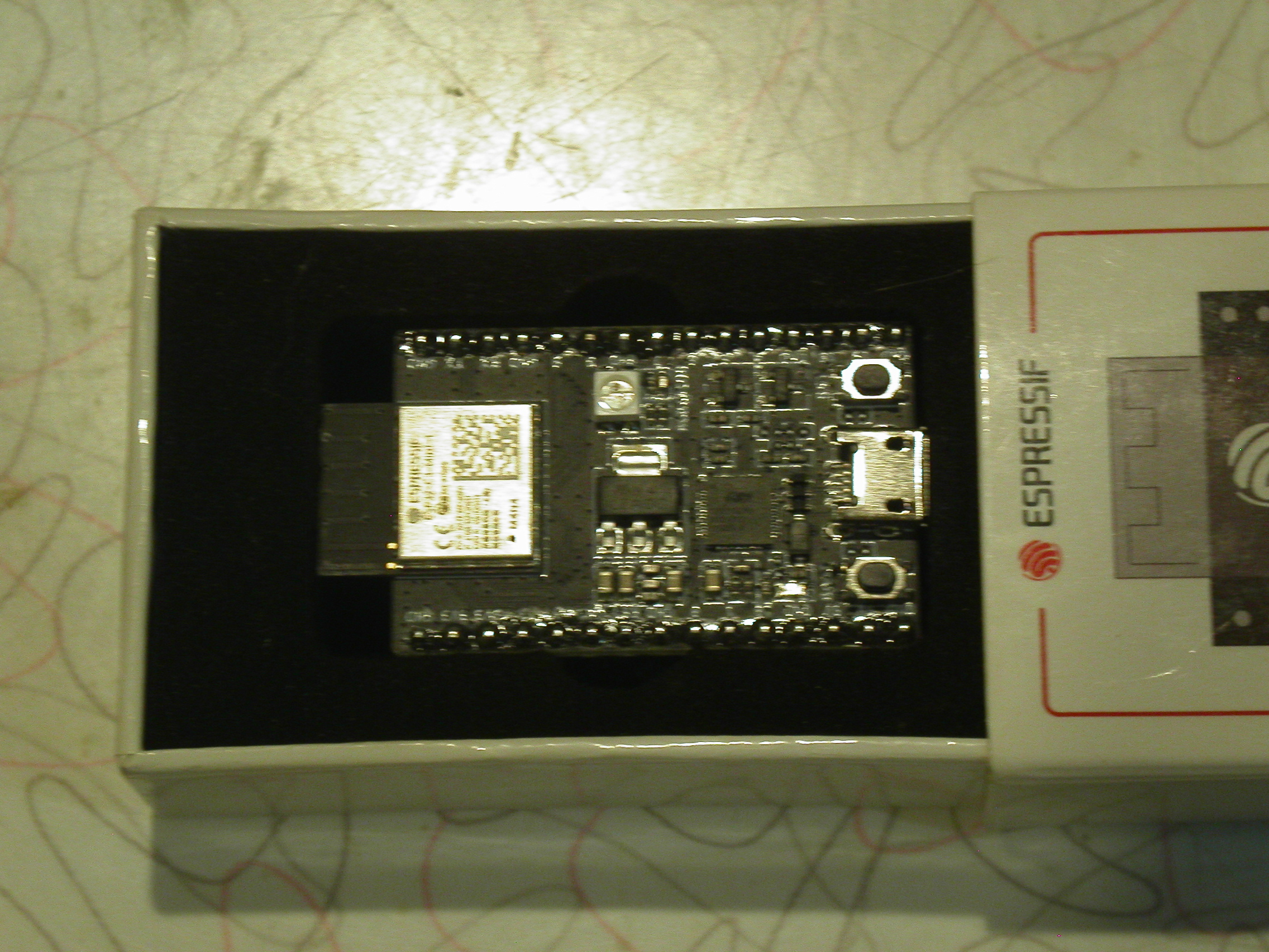

I just ordered two propeller 1 40 pin chips and just now realized I don't have a way to program them.
When Chip designed the Prop 1, his vision included a way to program them via RS232. As we know, the commercial prop plug emulates this. So it stands to reason that one should be able to use an ESP32 as an in circuit programmer, in the same way one would use a prop plug: USART to pins P30 and P31, a gpio pin to pull Reset LOW when it needs to, a 3.3v and a ground connection. The Prop burns the image to the 64k EEPROM that is connected via iic on pins P28/29.
Has anyone else been working on this, or something similar?

    The prop plug is just a fancy serial device with added circuit to do the reset logic the P1 needs.
    The Parallax WX module is an EPS8266 but includes the fancy startup code needed to program the P1. it emulates the reset logic.
    You also need the crystal that is no longer sold to make the P1 work. They do sell a faster one though.
    I had timing issues trying to program it but one could skip the hole issue by just programming the EEPROM directly with the program needed.

  • I am waaaaaay overthinking this
    I have a P2 EVAL board. I should be able to use this as a passthrough to Flexprop to program the Prop 1s, yeah?
  • Nevermind - was overthinking it. Checked the prop plug schematic and bashed something together- and took pictures! The ceramic cap under the board is a 100 nF cap and, as it turns out, is the special sauce of the reset pulse. LEDs are optional but pretty.
    Won't be able to test until Friday when my props come in, and I will post the code for the ESP32 later.
    Edit: file size for the pics is too large, will have to convert and post later.
  • iseriesiseries Posts: 1,536
    My problem is that you are going to use something like Proploader to flash the program onto the P1 using the ESP32 as the host.
    The proploader is going to send a DTR signal to the P1 for the reset then send a script to the P1 which it's going to look for a response.
    I think the DTR signal will reset the ESP32.
    I think you may have to turn the ESP32 into a Proploader and have it flash the program from there.
