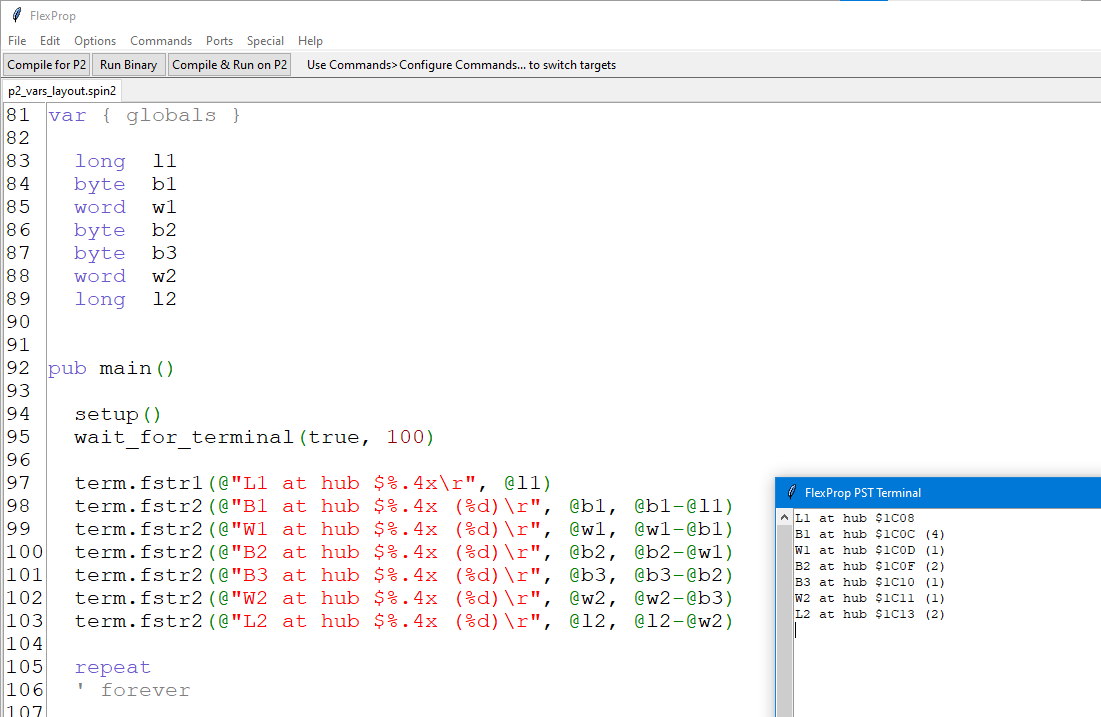

  • RaymanRayman Posts: 16,262
    @ke4pjw Doesn't Spin rearrange bytes and longs in VAR when compiling? Or, maybe that was fixed?
    Maybe compiler dependent, think prop tool does this but maybe SpinTools doesn't...
  • JonnyMacJonnyMac Posts: 9,795
    edited 2026-04-07 19:09
    P1/Spin1, yes. P2/Spin2, no. In Spin2 you can treat a block of variables like a structure. I did this early on with the WAV header. Back then FlexProp did rearrange by size, even in the P2. I don't know if that has changed.
    A few minutes later....
    FlexProp does layout as defined, too. Perhaps I'm mistaken and it always did.
    Works in Spin Tools, too.
  • ke4pjwke4pjw Posts: 1,312
    edited 2026-04-07 20:20
    @Rayman so far, Prop-Tool, Spin-Tools, and PNUT all work the same. If that changes, I will abstract the config, but so far, so good.
    Not sure if this works with flexprop.
    Looks like Jon verified it works too.
