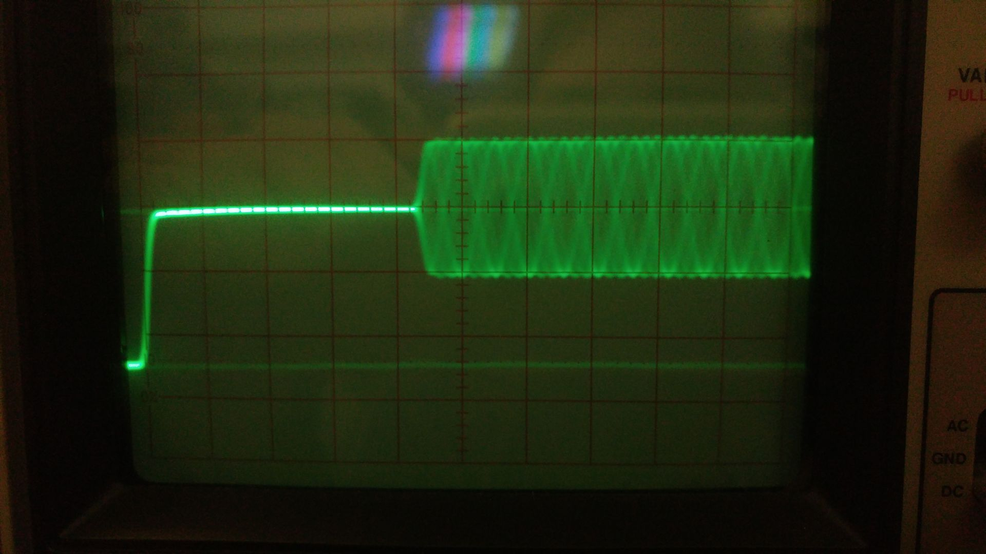

  • @Wuerfel_21 said:
    Color requires splitting the back porch into 3 segments: the breezeway, color burst and the remaining back porch that doesn't have a catchy name.
    To perhaps clarify and because I was looking through some old files and found this one again: The breezeway is the bit of blanking that goes between the sync pulse (left edge) and the color burst.

    The composite video signal does everything all at once. Sync pulses are just negative pulses between the active video (this is why black/blank level is at ~0.3V, so the sync pulse can go down to 0 V). Color is just a 3.58 / 4.43 MHz (NTSC/PAL) carrier wave that rides on top of the brightness. The amplitude determines color saturation and the phase determines the hue. This alternatively expressed as quadrature modulation (where I/Q (or U/V) are the carthesian equivalents to polar hue/saturation). As mentioned, the P2 hardware does it for you.
