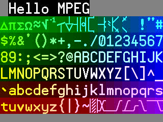

  • The coloring here is a test of changing only the U,V components of the video. The Y component is unmodified like it must be we were going to concatenate pre-encoded bitstreams.
    1920x1080 would give a 120x33 text mode. I don't see much of a point to pursuing a restricted text mode output. I would rather design for graphics. That way we could use any size text. Responsiveness would be fine if we only draw a few lines of text at a time. The concatenating text mode would not be able to update the full display every frame either. It would be restricted by the 19mbps ATSC channel.
    What I'm not really happy about is this encoder can only output 12 fps at 320x240 even though the discrete cosine transform and quantization is not part of that time. Those steps are done once as the image is generated before it's stored in the PSRAM.
    I've turned off the serial video output to test the time but that only gives a minor improvement. My JPEG encoder runs 32 fps and that includes the discrete cosine transform. I guess I would have to write a whole bunch of functions in PASM2 to match the performance.
