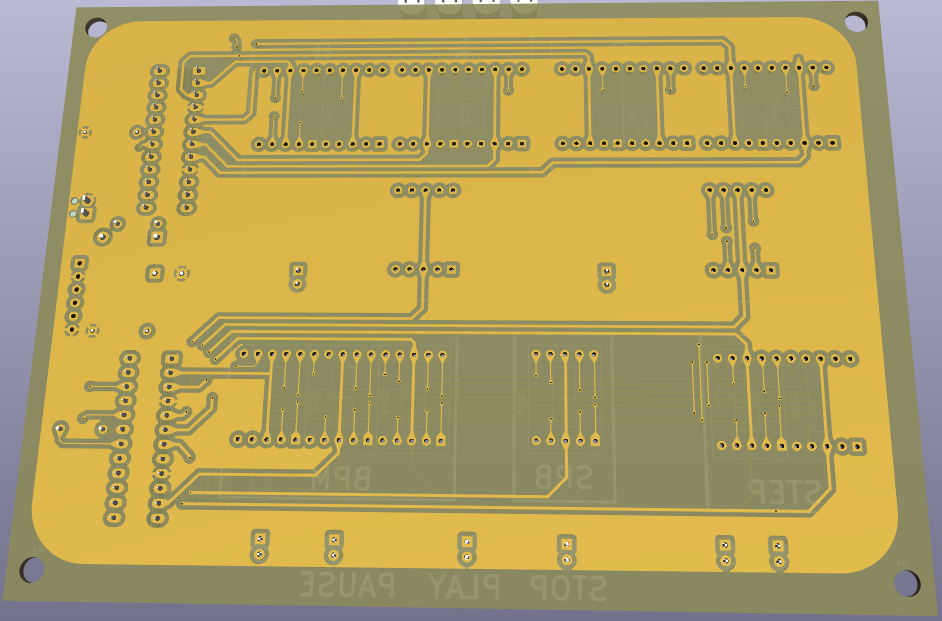

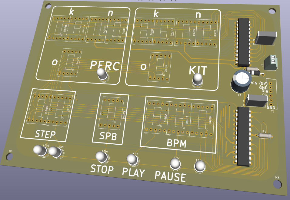

Now working towards a HMI 16 digit 7-segment LED display +indicator LEDs

I'm also playing with KiCAD PCB layout, MAX7219 is nice beginner project.

Thank you Pilot, I'm making some (slow) progress on MIDIBEAT1's MAX7219 PCB layout.
Considering using dp segments as LED indicators.
