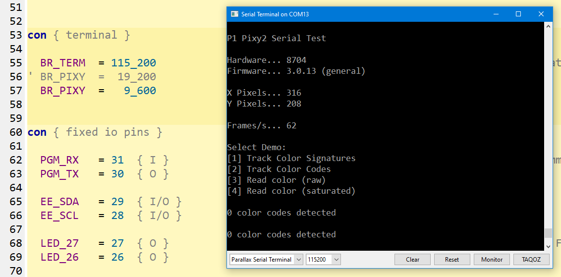

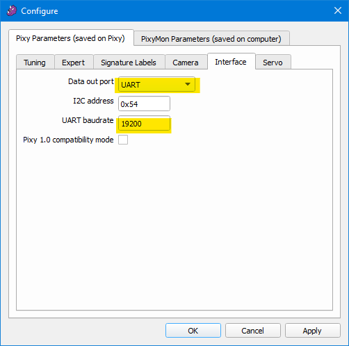

    • You failed to configure the Pixy2 for serial coms at 19200
    • You failed to connect to the correct IO pins
    • You failed to connect P1.TX to Pixy.RX and P1.RX to Pixy.TX
    • You failed to follow configuration instructions in the comments of the demo
    • You failed to follow the run instructions in the main() method (see first screenshot).
    The attached screenshots show the Pixy2 running on a P1 -- the only thing I modified from the code I sent you months ago was the TX and RX pins used.
    The code works on Propeller Tool, Spin Tools, and even FlexProp.

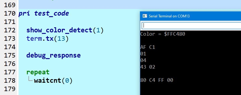

    OK if it is a checksum error how do I fix it.
    The checksum error is in the packet coming from the Pixy2 (the P1 doesn't use checksum when sending commands). That is to say, something is corrupting the data coming from the Pixy2 to the Propeller.
    If you want to dig in, that is, go into hacker mode and write a bit of test code to read something and then examine the packet. There is a method in the demo called debug_response that will show you the contents of the packet. Like this:
    I put my call to test_code right before the banner; with the infinite repeat doesn't exit that method.
    Here's an annotation of the debug output :
    Color = $FFC480         ' response from show_color_detect(1)
    AF C1                   ' response header ($AF = checksum is used)
    01                      ' RESPONSE_RESULT
    04                      ' four bytes in response
    43 02                   ' checksum (Little Endian $80 + $C4 + $FF + $00)
    80 C4 FF 00             ' payload (also Little Endian)
    I the end, I have demonstrated that my code works. Why it doesn't work for you is something that you'll have to sort out -- I've given you as much direction as I can.

    115200 won't work with the P1 version of the code because the serial is done in Spin1 so it's limited to 19200. I did a quick try at 9600 baud and that works fine. Remember, you have to use PixyMon to set the Pixy2 baud rate to 9600.

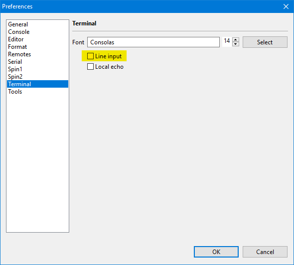

    Note, too, that when using Spin Tools the terminal should not be set to line input. Again, the program was coded more than five years ago when all we had was PST and they way it handles input. If there is a white text input box at the top of the Spin Tools terminal, you're in line input mode. Turn this off in the preferences.
