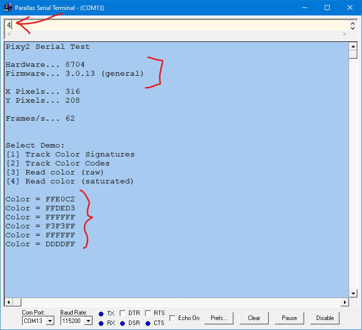

  • JonnyMacJonnyMac Posts: 9,752
    edited 2026-03-18 21:42
    None of the jm code works
    Yes, it does. I'm guessing...

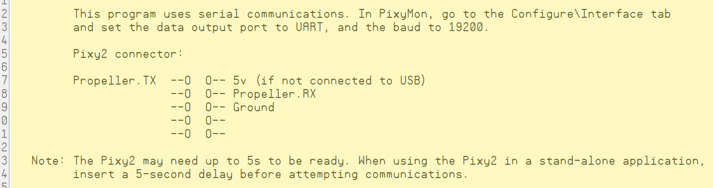

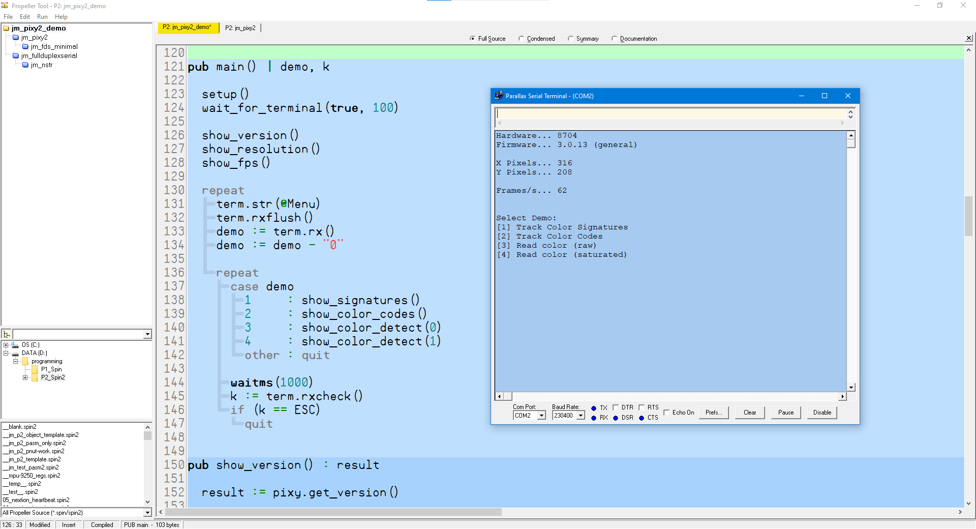

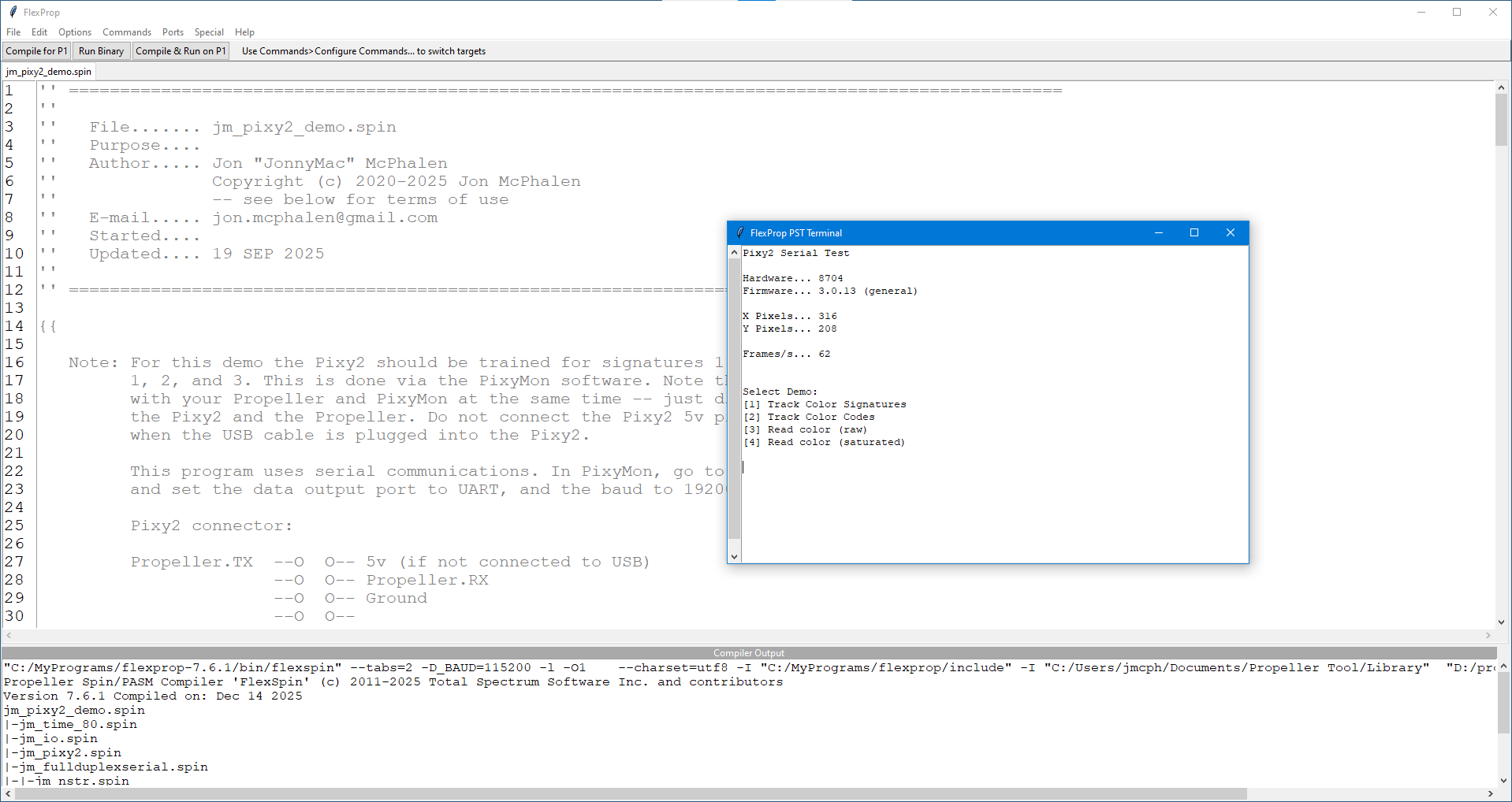

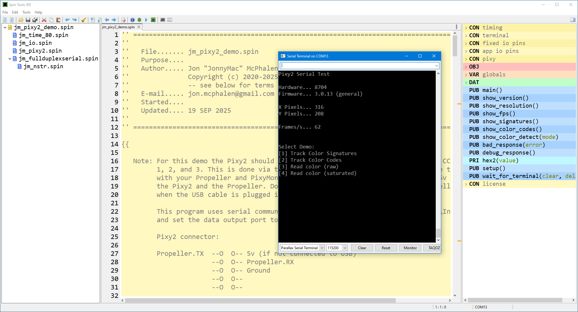

    • You failed to configure the Pixy2 for serial coms at 19200
    • You failed to connect to the correct IO pins
    • You failed to connect P1.TX to Pixy.RX and P1.RX to Pixy.TX

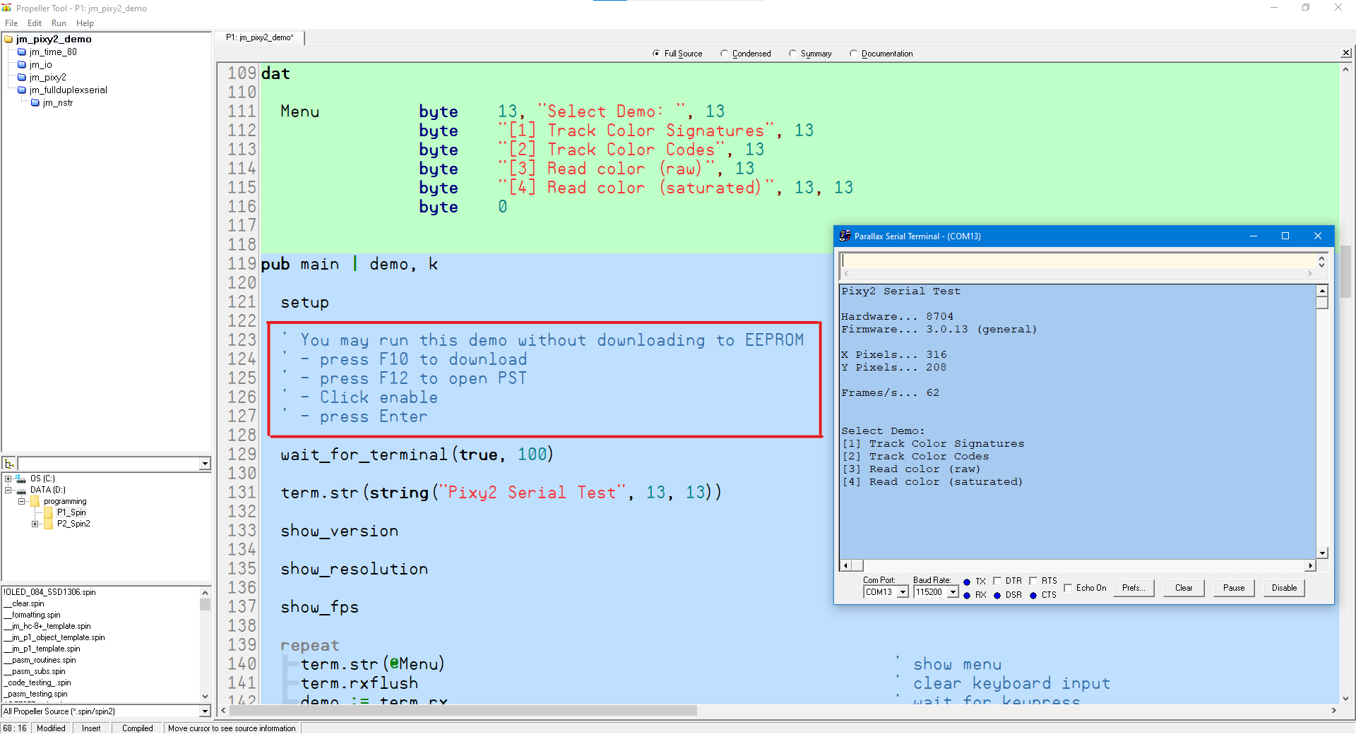

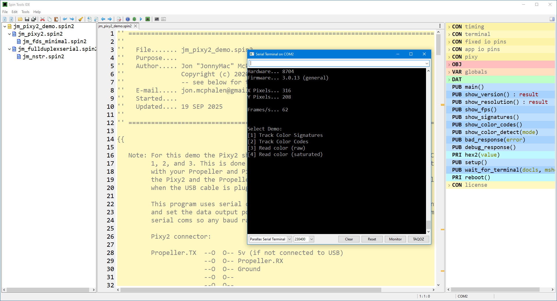

    • You failed to follow configuration instructions in the comments of the demo
    • You failed to follow the run instructions in the main() method (see first screenshot).
    The attached screenshots show the Pixy2 running on a P1 -- the only thing I modified from the code I sent you months ago was the TX and RX pins used.
    The code works on Propeller Tool, Spin Tools, and even FlexProp.

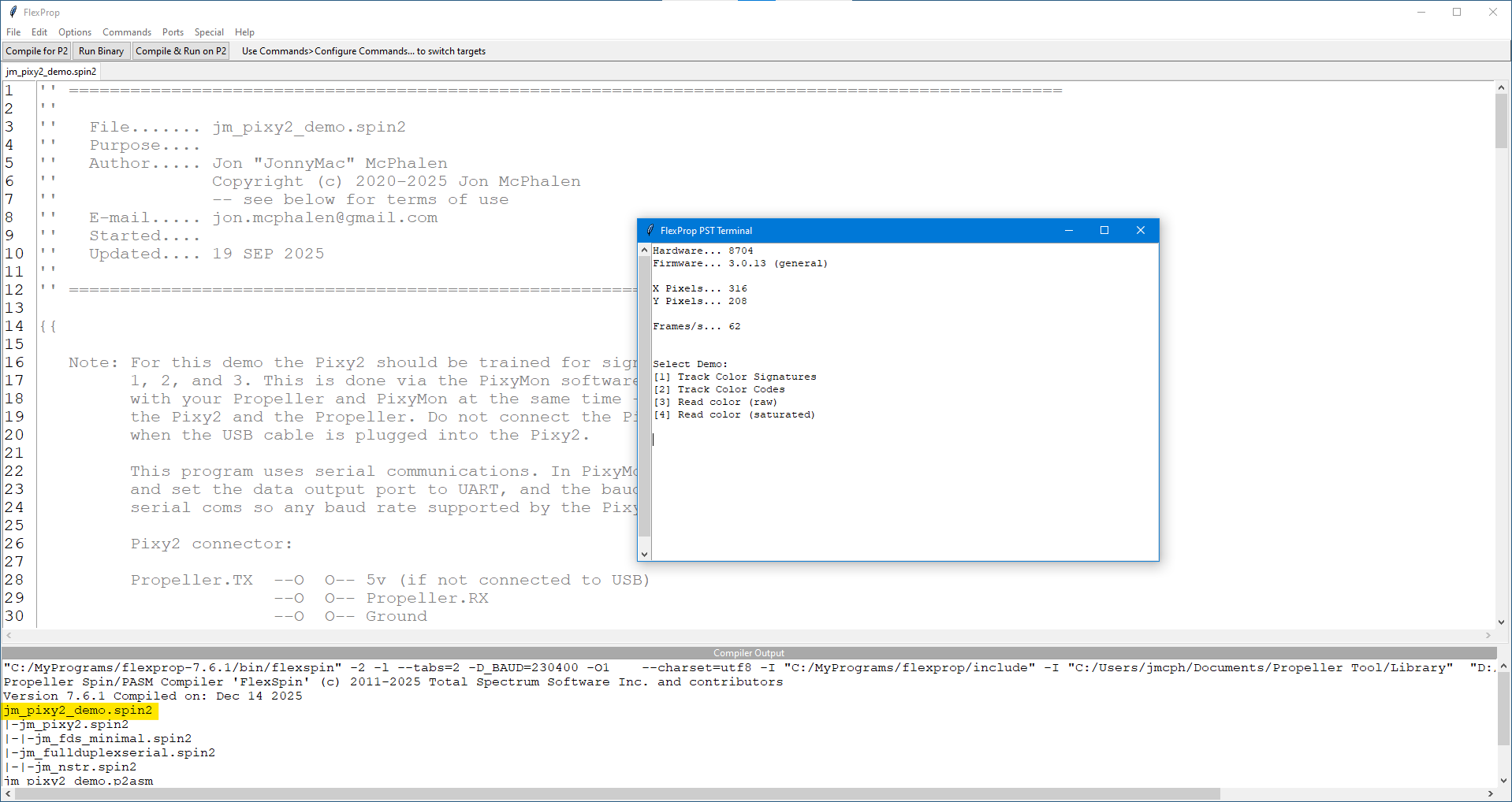

    edited 2026-03-18 14:26
    Oh, look, it works on the P2 as well.
    Note that there was a CLS command that was removing the version, resolution, and frame rate information from the initial display, so I took that out -- otherwise, the code is as it has always been.

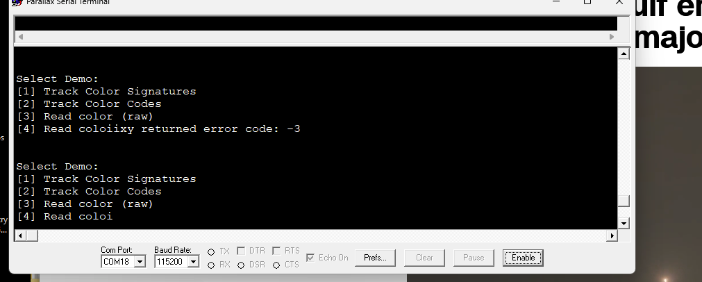

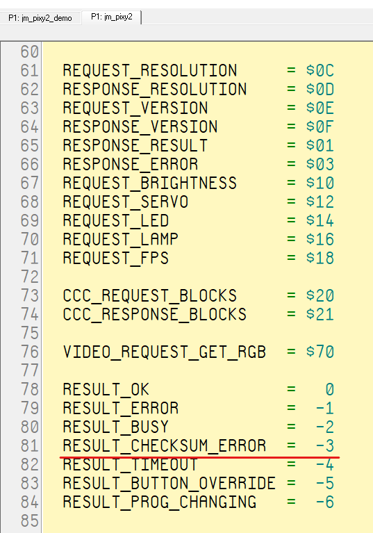

  • I was very careful to follow the instructions and pins.
  • Your code says error code 3 returned.
    The API has these errors:
    PIXY_RESULT_ERROR
    General error result
    PIXY_RESULT_BUSY
    This is returned when Pixy has no new data. It is used in polling mode, as opposed to blocking mode.
    PIXY_RESULT_CHECKSUM_ERROR
    This is returned when the data packet received contains a checksum error.
    PIXY_RESULT_TIMEOUT
    This is returned when Pixy2 has taken too long to return its result.
    PIXY_RESULT_BUTTON_OVERRIDE
    This is returned when the user is interacting with the button (e.g. teaching Pixy a signature) and can't perform the requested action.
    I went through your code and could not find error 3 nor an explanation.
    edited 2026-03-19 13:56
    Shocker. Here we go again. You went from...
    None of the jm code works, sorry. I have tried the spin code in propeller tool and the spin tools ide. Just sits.
    to...
    Did you finally read the instructions that you have to press a key once the terminal is open? This code was written when Propeller Tool / PST was what most of us used, and I haven't done anything with it since.
    Here's what I get on my system with select #4 (the others work, too).
    It's possible that you have a device with different firmware with a modified API -- that's why I show that information in the initial screen.
    You mean this?

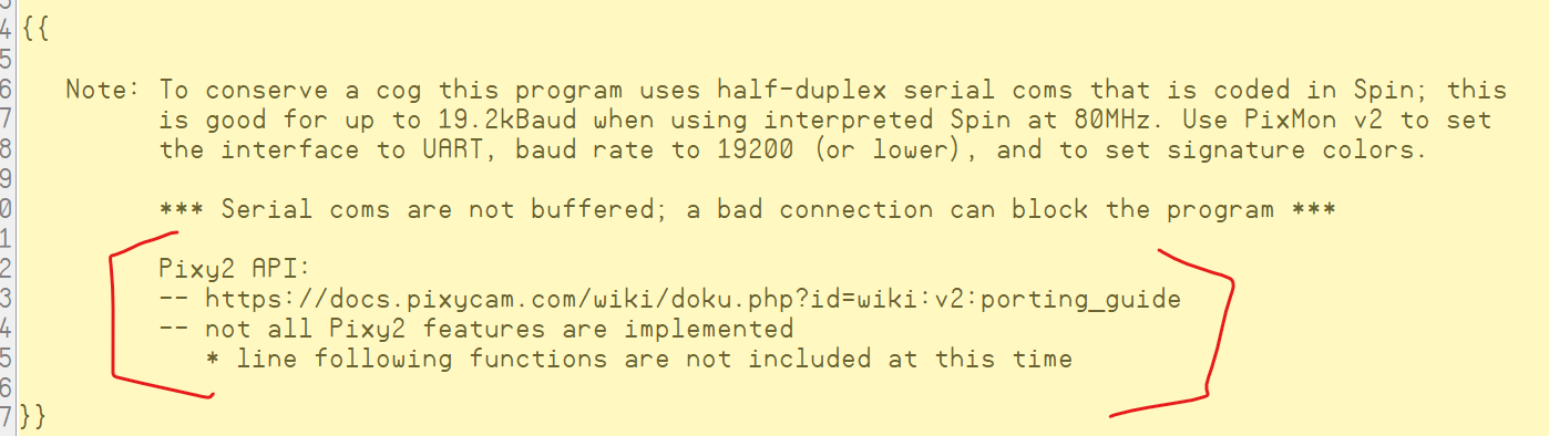

    When I wrote this program for Ken he and I both tested it and never had a communications error. Ken then deployed it in robot projects. If you have bad wiring, connections, or noise, there could be an issue. To save a cog for use in small P1 robots the serial code is not buffered (that is, the Pixy2 serial coms are in Spin1). In the P2 code I do use a serial cog so if you want to write a P1 driver using that model, be my guest.
    It was never Ken's intention nor mine to make this a full-fledged driver that enabled every Pixy2 feature -- it even says so in the object comments. There is also a link to the API page so that anyone wanting to do more than the basics knows where to get the correct information.
