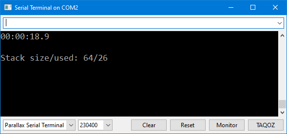

    A couple years ago I was porting my 8-ch servo driver to the P2 and having some weird problems (that turned out to be unrelated to the servo code) so I wrote a little stack monitor object. If you're using this with an external object that uses a Spin cog you need to add a method to your object -- it tells the monitor the size and location of your stack.
    pub stack_details() : addr, size
      return @stack, STACK_SZ
    The stack monitor code will fill the stack with a test pattern which will be used later to examine & estimate stack use. I did a small clean-up of the stack monitor code and have attached it with a demo.
    I added a couple of stacked calls that are easy to play with to see the affect on the background cog stack.

    Flexprop compiles this and runs, using 6 out of 64 stack locations compared with Spin Tools 20/64 stack locations. Multitasking - could save a lot of space there too.
