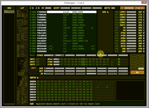

Does anyone know if Chip's runtime debugger standalone program works with flexspin debugging output? And if so, can it be made to work with MacOS Ventura?
I'm having a hard time tracking down what looks like some sort of stack corruption bug and using a decent debugger that I can step through blocks of code and examining memory would be very handy right now. I tried running Stephen Moraco's Pnut-Term-TS which looked good hoping that would help but found it doesn't yet support the run time debugger feature.
Wading through hundreds of output lines of hex numbers and stack frame data values is not exactly fun trying to locate when this potential corruption occurs and it's becoming tedious. Also to make it harder this problem has the tendency to morph when the code is changed trying to add debug statements to find it (Heisenbug).
@evanh said:
Where is this standalone debugger program hidden?
I mean the PNut debugger tool Chip wrote where you could examine COG/HUB contents and step through/trace code etc. I'm not sure what it is actually named or it if is already built into his own tools etc as I don't have a PC to use them. P2 documentation mentions it fires up when the DEBUG command is inserted in the code without parenthesis.
I think that the debugger is built into PNut, hence not really "stand alone", so alas it won't work with FlexProp. That's as far as I know, I could be wrong.
Oh, I was sort of hoping the underlying debug mechanism would carry the information needed for presenting the state. But if it's a slightly different port between flexspin and PropTool/PNut that might prevent that from happening... Maybe @Wuerfel_21 has some insights there. It makes sense that there couldn't be source file integration in that case, but I was hoping it might still present data as shown above and let us setup break's and/or single step the code. General stuff that wouldn't need to know the actual executable format or SPIN bytecodes etc.
Okay, Eric's comment prompted me to look at what Pnut can do ... I found an option I hadn't noticed before: -debug. It provides debugging mode without any file downloading. So that's as good as stand-alone really .... huh, and the feature has existed since early 2021.
Generally step debugger should work, as far as the P2 side is concerned. Getting the PC side to sync up to it, idk, don't think I ever got it to work (for lack of trying, tbf).
Note that I think flexspin's debugger code might be a couple versions behind PNut? The last time I merged in new changes was a long while ago. Not sure if there's any incompatible protocol versions.
Thankfully I finally just found and fixed the bug in my code that was trashing memory and holding me up. One missed subtraction instruction where it was required. Now I can run the partially ported CoreMark benchmark code. NOTE: only 1 of the 3 benchmark tests included are currently running from simulated external memory, i.e. the linked list processing code. But the main thing is that it is actually now running! With this issue handled, I should now be able to port the other two benchmark routines (matrix multiplication & CRC handling, and state machine processing) and also make it run from real external RAM.
EDIT: This tool :
-debug. It provides debugging mode without any file downloading. So that's as good as stand-alone really .... huh, and the feature has existed since early 2021.Generally step debugger should work, as far as the P2 side is concerned. Getting the PC side to sync up to it, idk, don't think I ever got it to work (for lack of trying, tbf).
