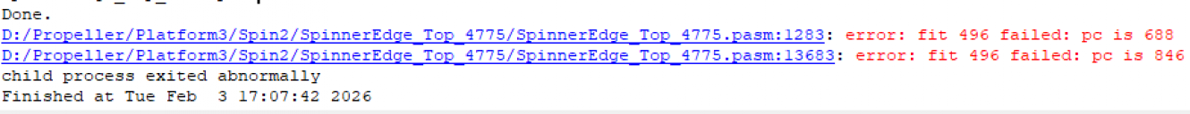

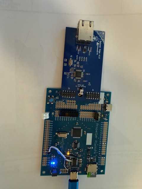

    Took a stab at something much more difficult, "Spinner Edge", a W6100 based ethernet board...
    Got it to compile to pasm, basically by commenting out all the inline assembly and also some smartpin things.
    But, can't convert pasm to executable. The error message doesn't say exactly, but I'm pretty sure this is well over the 32 kB that P1 has.
    There are some steps that could make this work though
    • convert FAT32 to P1 fsrw
    • convert spi driver to P1 spi driver (either slow spin one or faster asm one)
    • Adapt W6100 driver to work on P1.
    This last one is probably the majority of the work...
    An easier path might be to compile the C driver for P1 and try that.
    This will probably work, unless it comes out too big, which is possible...
    The Spin W6100 is probably a lot smaller than the C driver, from what I remember...
    Either way looks like some work, so I'll probably skip this and try some more hardware....

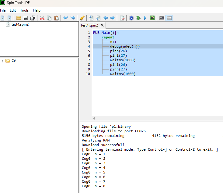

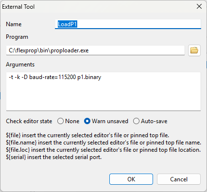

    Just figured out how to compile and run Spin2 on P1 using SpinTools IDE.
    Took a while to figure things out, especially how to have debug() work...
    Anyway, this is enabled via the Preferences->Tools dialog, where you can enable external tools.
    This requires FlexProp to be installed somewhere too, in this case at C:\FlexProp
    So the first external tool (activated by alt+1 on keyboard) is rigged to compile for P1 (using flexspin.exe): -1 -O2 -g -D_BAUD=115200 -L C:\flexprop\include -o p1.binary ${file}
    The second tool (alt+2) is rigged to load P1 with the generated p1.binary file from first tool (using proploader.exe): -t -k -D baud-rate=115200 p1.binary
    The screenshots below show these external tool dialog settings.
    This is nice because I'm used to the colored background that SpinTools provides as well as some other niceties.
    I'm also really liking how can use debug.
    This isn't the real, interrupt driven, debug like on P2, think it's more like regular serial output.
    But, it can be useful. This is enabled by that "-g" flag for the compiler, shown above.
    733 x 633 - 34K
    426 x 396 - 16K
    426 x 396 - 14K
  • RaymanRayman Posts: 16,010
    After the above is all set up, you just do alt+1 to compile and then alt+2 to load.
    Looks like these could be combined into one step using multiple lines in the external tool command, but think this is good for now...

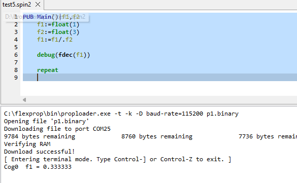

    Wow, floating point works automagically with Spin2 on P1.
    Really liking this. Didn't make program size explode too much either...
    Think there is a fixed point option that would presumably reduce the file size a lot...

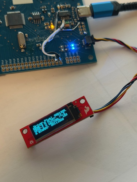

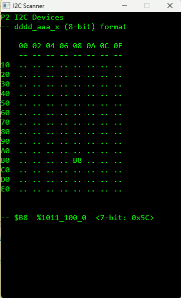

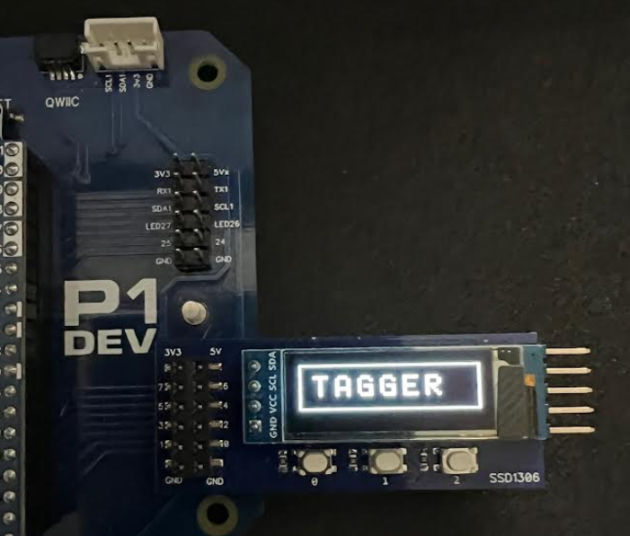

    Seems like QWIIC accessories are a place where a common Spin2 file for P1 and P2 makes sense. Don't imaging smartpins help a whole lot with I2C. Although for best performance, maybe P1 needs an assembly driver...
    Anyway, got this Sparkfun SSD1306 based 128x32 OLED working with a hacked version of an OBEX code for 128x64 display. Guess I'll turn this into Spin2 and see if it really can work for both P1 and P2.
    Not actually happy with how this code is using a page system to define lines of text and doesn't have any graphics besides text.
    But, going to go with this for now.
    Also, the text is very small... Maybe will have to change it to larger font. Or, was reading somewhere about someone doing a 2X scaled font, that might be easier.
    But, P1 also has it's ROM font that might be perfect for this, or the "hidden" version for half size...
    So, maybe a universal driver is not going to be ideal... Going to look at it anyway...
    edited 2026-02-05 18:22
    Working on the @JonnyMac ssd1306 driver. Think liking this one better than the other one because has graphics... (and bigger font option).
    So far, have converted the driver into Spin2 in a way that should work on both P1 and P2.
    Working on P1 for now. Will test on P2 after the test file is also converted.
    With delays removed, the original loop took 1.9 seconds to complete.
    This version takes 1.2 seconds, and it is without any assembly. Compiling with FastSpin probably makes it fast enough to achieve 400 kHz without assembly.
    (although fastspin converts everything to assembly internally...)
    But, the driver is now not using the pullups exactly as should. Should only be pulling down pins and letting the pullups float them up high.
    A lot of older code did this, think an easy fix.
    Add in some delays to make it really 400 kHz and should be good.
    edited 2026-02-05 18:42
    Ok, main test file is now in Spin2 and works on both P1 and P2 :)
    The I2C driver here needs fixing up, but works anyway.

    All in all, this seems to have worked out nicely. Think have to try out some other QWIIC stuff...
    The only perhaps unfortunate thing is that this is only to work with FlexProp.
    Like to have multiple options.
    But, the niceties of Spin2 is tempting me to overlook that...
    Slightly improved version of I2C driver for P1 and P2:
    Hmm.. Just realized that the above was working on P2 only because the QWIIC Oled module has it's own i2c pullup resistors...
    Probably need to add option to enable P2 internal pullups just in case there's a module that doesn't have pullups...

    Wow, just got a surprise...
    Was working on adapting an @JonnyMac debug I2C scanner to work on both P1 and P2 in Spin2...
    Doing this with the SpinTools IDE...
    Did not really expect the debug window to work at all in P1 mode.
    Instead it popped open a window and displayed the result just like on P2!
    This was definitely a welcome surprise. Might be some other debug things work as well...
