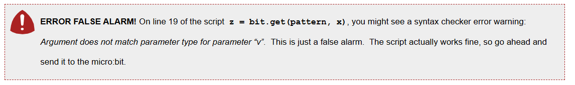

  • Can you please confirm if the code runs?
    The syntax checker sometimes flags code that is actually correct.
    We have reported these issues to The Micro:bit Educational Foundation.
    But please first confirm if the code still runs once you send it to the micro:bit.
  • Sometimes we add some boxes to the curriculum like this one:
