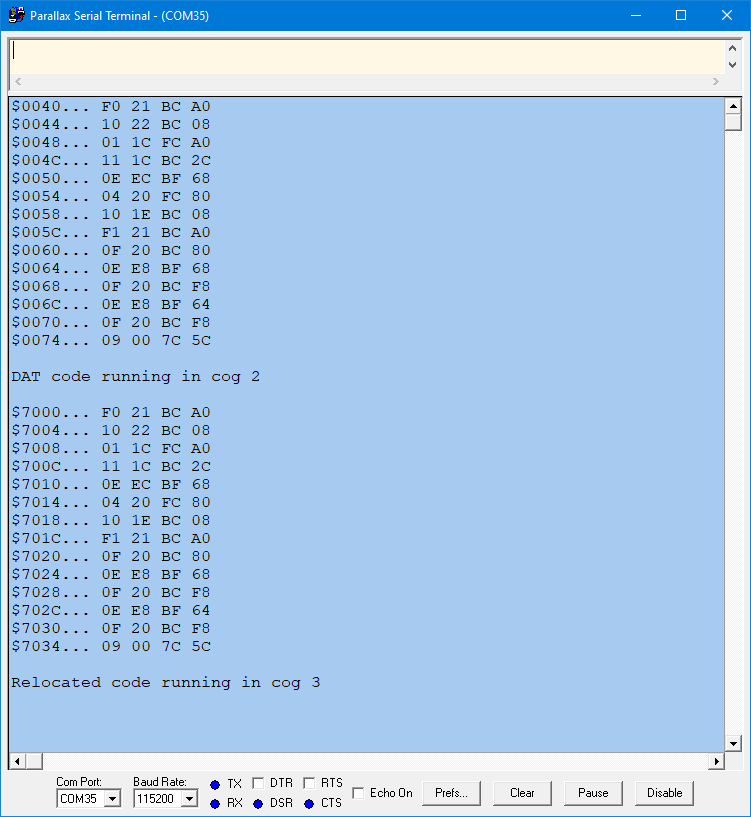

    Just for fun -- but I don't know how useful this will be -- I took that little blinker demo, copied the DAT section to upper memory, and ran it from both places. Each instance is running on its own pin with its own blink rate.
    This is the output from the program.

    You don't actually need a second DAT section -- just put the marker at the end of your PASM code.

    Hexadecimal is simply a display convention for programmers; internally, the numbers are the same. I'm sure you know this, but as I'll remind myself and others, the hub RAM looks like an array of bytes while the cog RAM looks like an array of longs.
    I still don't know why you'd want to relocate code from hub RAM to hub RAM before moving it into a cog. Since you can read the assembled source out of a DAT section, I thought it might be interesting to write that to a file, and then read it into a RAM buffer that could be transferred into a cog and run. I tried it, and it works. I went with Ray's suggestion and put the code buffer at $7800 which is the last 2K in hub RAM, just enough for cog code.
