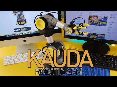

    I am using a Prop chip to run thishttps://duino4projects.com/open-source-robotic-arm-for-all-purposes/ , which uses an Arduino and I know that the signal there is 5 vdc.
