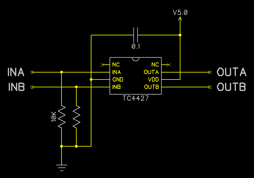

  • JonnyMacJonnyMac Posts: 9,799
    edited 2025-12-29 03:38
    Any tricks?
    I use the TC4427 to drive servos and other 5v signals (e.g., pixels). The TC4427 has a stiff output (and can sink/source up to 1A), so it's good over long cables.
    A momentary movement then nothing.
    Servos draw a lot of power when they start moving. Make sure your 5V supply can deal with that. Your board may be resetting.
