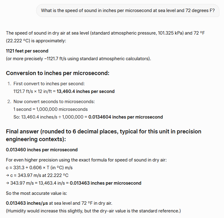

  • I did a quick query on Grok:
    If you want to go with Grok's number, the RawToIn value would become 882. Now that you know the process, you can decide what's best for your code and adjust as needed.
