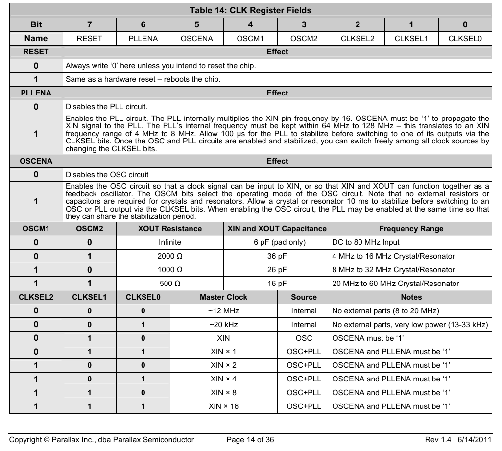

    PPS: For a crystal, you don't want any capacitor added to the PCB. The OSCSEL = 1 is 36 pF loading internal to the Prop1 XI/XO pins. And if you think that's too much then use OSCSEL = 2 instead.

    They have natural capacitance, yep. They'll all work stable, but maybe not to spec. The Prop1 applied capacitance shifts the resonant frequency. You should be able to measure the change when changing the clkset() mode bits.
    At least that's my limited understanding.
