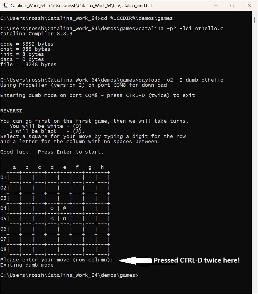

Ha! Logged into a new PC today, and found this old issue again, which I had forgotten about ...
In Windows 11, the default application to use when executing batch files etc now is the Terminal app, not the Windows command processor (i.e. cmd.exe).
The Terminal app is ok for simple command line use, but there are a few things (such as the payloadi batch script) that won't work correctly under the Terminal app. To make them work correctly, you can either go to "Settings" in the Terminal app, and set the "Default Terminal Application" to Windows Console Host (instead of Windows Terminal or Let Windows Decide).
Or ... you can open the properties of the "Catalina Command Line" desktop shortcut (and/or the Start menu entry) and change the Target (for Catalina 8.8.3) from: "C:\Program Files (x86)\Catalina_8.8.3\bin\catalina_cmd.bat"
to conhost.exe "C:\Program Files (x86)\Catalina_8.8\bin\catalina_cmd.bat"
Also, at least one of the Catalina Geany Build commands need updating. Change the Download and Interact command to:
conhost payloadi.bat %x "%p\%e" -b%b
Note the inclusion of the ".bat" suffix - this is required.
I will try and remember to fix this properly in the next release.
Windows Terminal isn't another shell - it's a new terminal emulator that's actually not broken in every conceivable way, unlike the ancient Console Host... It's a gem amidst all the other trash they've been adding to Windows. You can run cmd, PowerShell, WSL, or I think any other shell that will run on Windows inside of it.
Windows Terminal cannot be resized by an application running in it. This is the main functionality that conhost offers that Catalina's payload utility uses (when run in interactive mode).
Mostly on Windows, I just use the shell to run payload in non-interactive mode, and then use a proper terminal emulator, so I forgot about this annoying issue because I can do that from any of cmd.exe, Powershell or Terminal (or bash, for that matter).
Still, it can probably be fixed, so I will try to do so in the next release.

Ok! That turned out to be easier than I thought, so here is a new version (8.8.4) of payload that implements a "dumb" terminal capability. I have included a windows binary, but on Linux or Pi OS you will have to compile it yourself - just unzip this stuff into Catalina's source/catalina directory (and either copy the binary to Catalina's bin directory or execute build_all)
To use it, you just specify dumb as the external terminal type (i.e. using the -I option, such as -I dumb). Here, I used the game of othello as an example (on Windows):
Here is what you see:
A few things to note:
In dumb mode, payload does not do any terminal emulation - it just transfers characters between the Propeller program and the terminal window in which it is executing. If the Propeller program does any "clever" stuff (e.g. cursor movement, screen manipulation, applying colors etc) this will work if that capability is implemented by the terminal window in which it is executing. In general, this means many things will work quite smoothly (in Windows) using cmd.exe, conhost or the terminal app, or (in Linux) in any window type derived from an xterm - but some of these are even as complete a terminal emulator as payload's simple internal one, let alone a proper external terminal emulator. So while many things will work, some will not. If you need everything to work, use the -I vt100 payload option on Windows (which uses Comms) or PuTTY on Linux.
To exit dumb mode (and return to the terminal window), press CTRL-D twice. There is a known issue with programs that use the linenoise library (such as Catalyst) which means this may not work at the beginning of a line - if it does not, just first enter a space (or any other character) and then press CTRL-D twice.
Payload turns echo off when it enters dumb mode, and restores it when it exits. If it fails to exit gracefully, echo may still be turned off in the terminal window. On Linux, you can turn it back on by entering stty echo (even if you can't see what you are typing!). On Windows I do not know of an equivalent command - you may need to close the window and open another.
