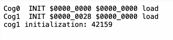

    2. For my test I have used a binary which was build with Spin Tools IDE. The little program uses two cogs. I used 2Mbit for communication. The logging of debug was working fine but for cog 0 it shows unexpected output and that 4 times the same.
    There is some hex output instead, but it looks like this is from the missing message for cog 0.

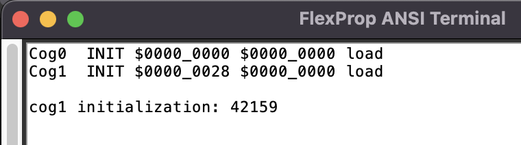

    The same binary shows the expected debug logs with Spin Tools IDE and FlexProp. On FlexProp you can use "Run binary on device..." from Commands menu to try.
    1. In the debug window and in the log file the message from the program is shown with the used control characters (line feed and new line) instead of doing it. This is not the case for messages coming from debug kernel.
      On the other used tools it is printed as expected.
    2. In the log file the timestamps are shown as UTC but the file name uses local time.
    Overall I can say it is working so far but differ from the output of other tools.

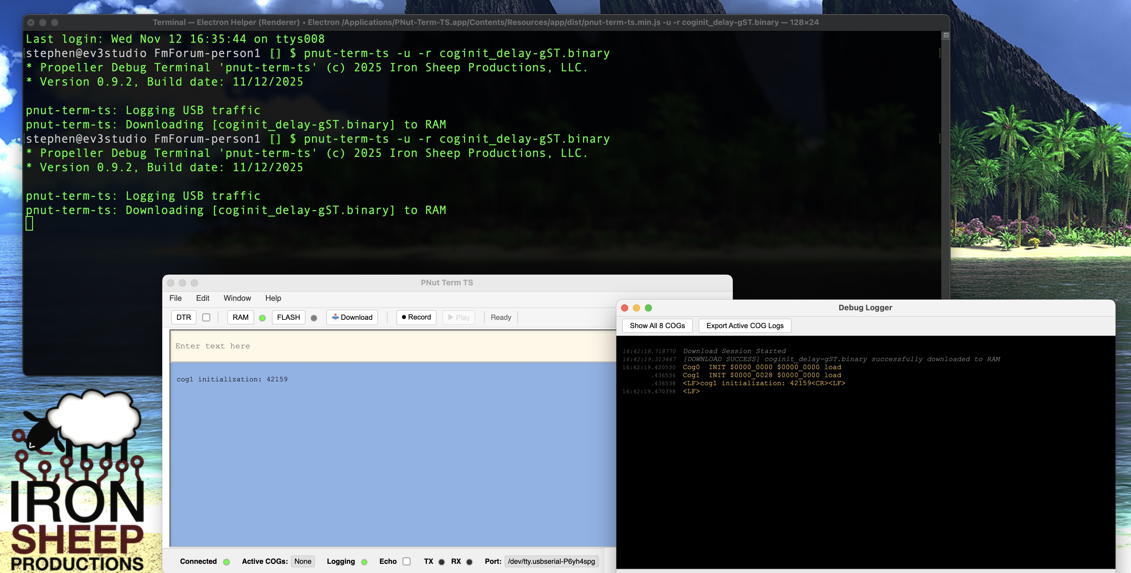

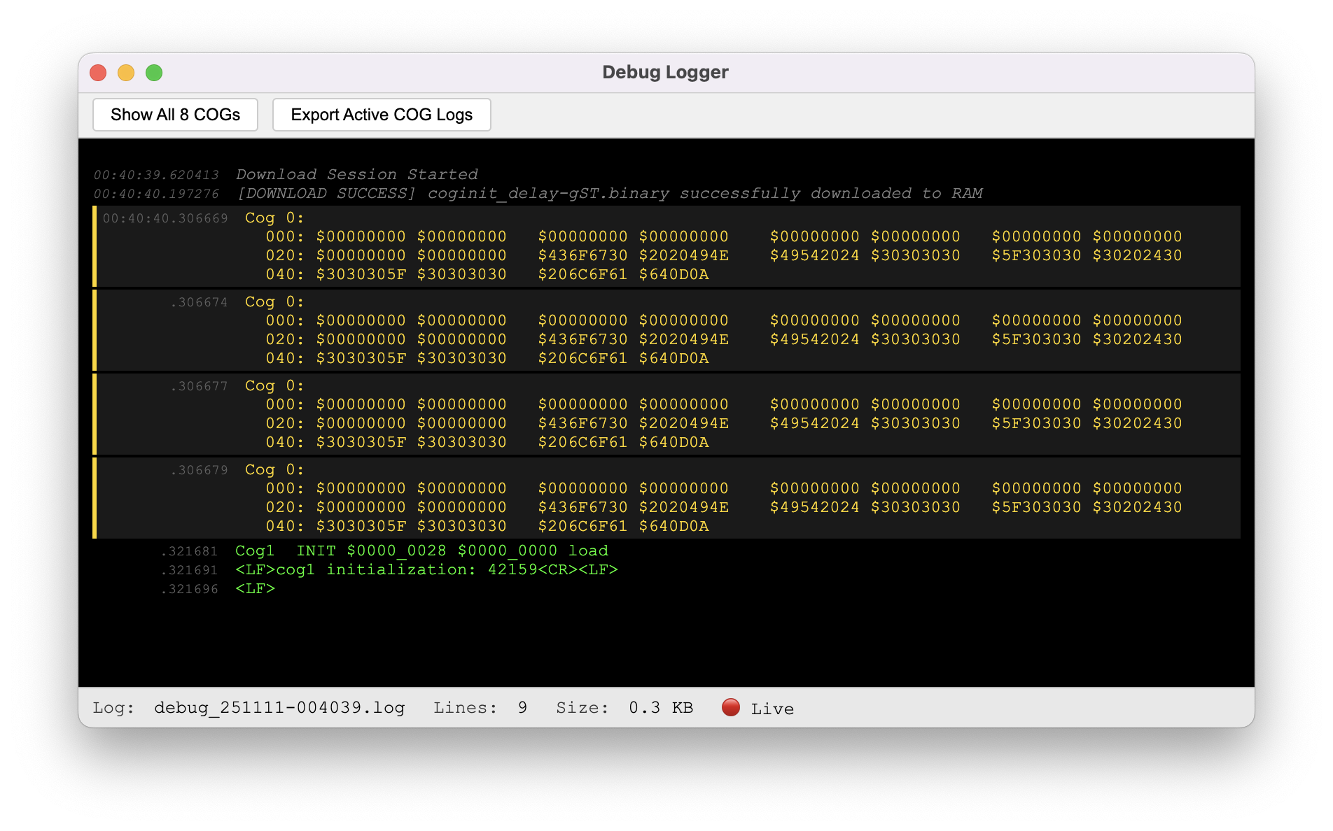

    @Kaio, I ran your application. The binary with a PNut term to see what you were seeing in the logging. Here's what I saw:
    You can see that your message (undecorated) is shown in the main window, which interprets CR, LF, PST Commands, etc.
    But in the logger, the control codes are shown, so we can actually see what we are receiving from or sending to the P2. This way, we can actually see ANSI sequences, clear-screens, and similar things being sent from the P2 appear in the log. We see what they are, so you can verify that you're sending them in correctly, even when the display in the main window isn't painting as you expected.
    This is a design choice, not an error. Does this make sense?
