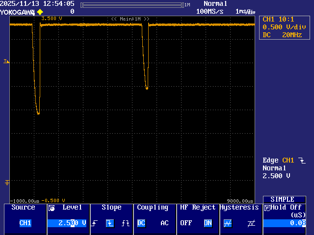

Hmm, I've just realised I'm getting the identical behaviour with Flexspin's sdmm driver too. It's only happening with one of my uSD cards (Sandisk Extreme 64 GB, dated 2024) and only on the boot pins. Put that same card in the 4-bit add-on slot and no problem with it either. Same for both Flexspin and Catalina compiled programs. The pull-up on DO doesn't appear to be the issue, although without it sdmm can't init any SD card.
Specifically, on every second init sequence the 64 GB SD card is reporting from CMD58 as byte addressable SDSC, and only 30 MB capacity reported in CSD register (CMD9). The card seems to change config somehow. And has probably always done this but I only just noticed first when testing with Catalina.
Solved. I've moved R802 to R801 position on the Eval Board, permanently enabling the voltage regular that powers the boot SD slot and Flash EEPROM. This prevents the reset circuit from power cycling these parts.

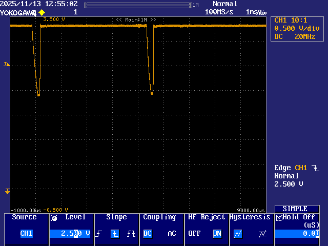

Scratching my head a little here.
Here's the supply volts for the power cycle that succeeds in resetting that SD card:
And the one that doesn't succeed:
Neither of them are even close to achieving the SD spec for power cycling. Which is to fall below 0.5 Volt for at least 1.0 millisecond.
